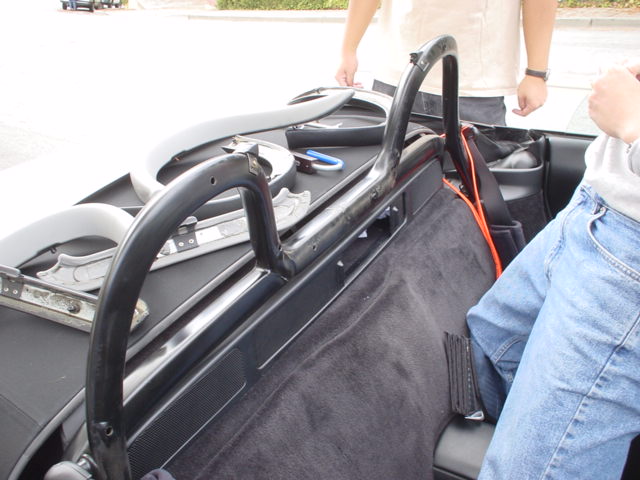

Looks like the 986 kit. I can even see the pop rivets
You just pry/pull the roll bar pading off, same as a 986. You can do it with your fingers if you have strong hands. I use a trim tool, just because I have one.

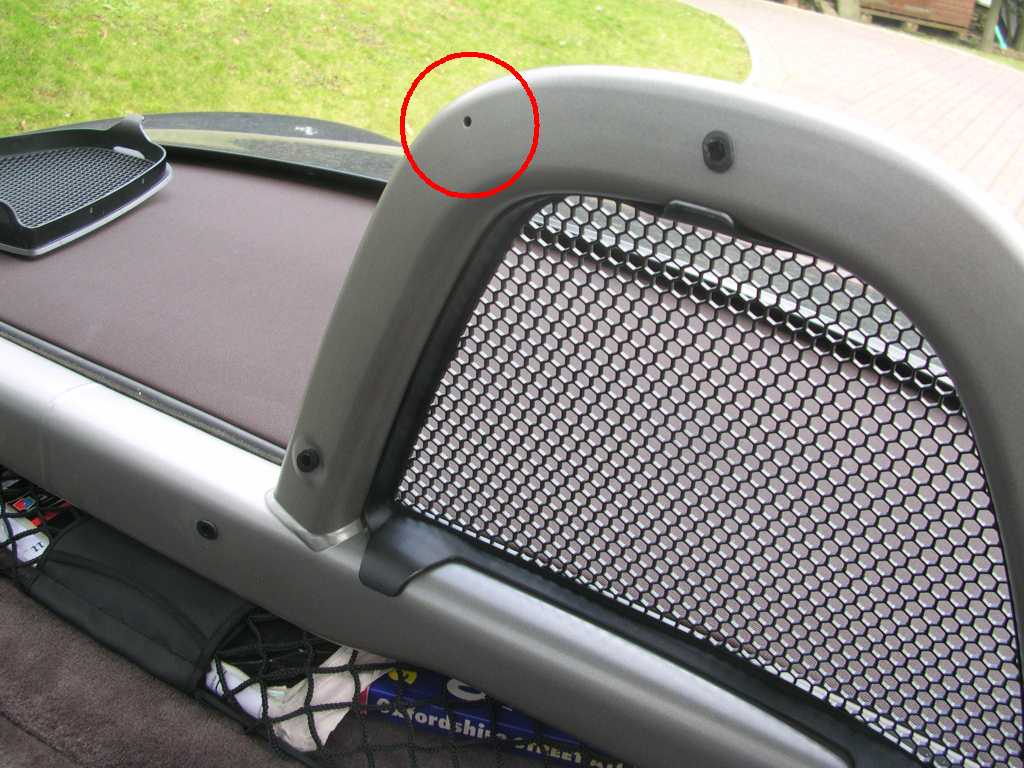

The side clips need 1 rivet per clip. The 987 roll bar does not have a pre-drilled hole like a 986. But there is a dimple for where to drill. The rivets are metric. On the 986 they are also metric but I used a 1/8" bit.

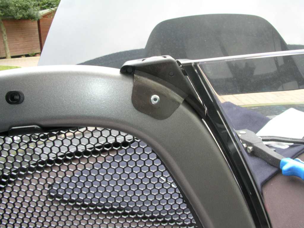

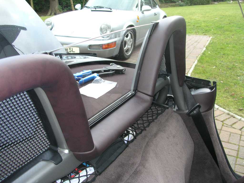

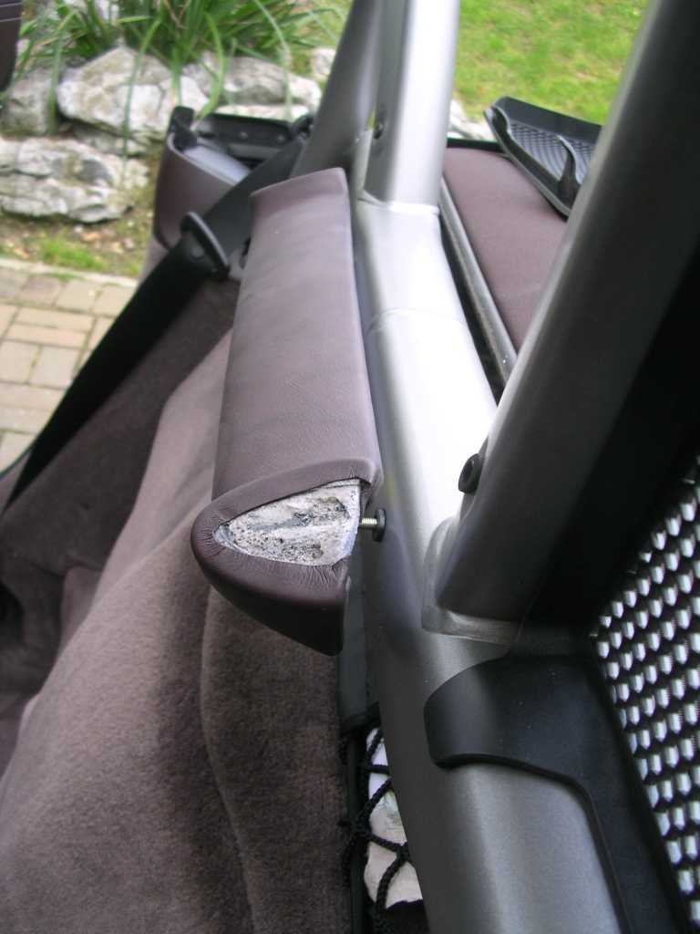

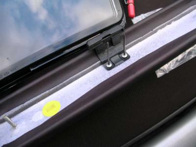

Finally found my rivet gun, so here's the installation:
1. Lever off the padding with a plastic lever to avoid scratching up the paint. There are M5 studs in the back of the padding which press into nylon inserts in the roll-hoops. They're pretty firm, but will budge with enough brute force.
2. Rivet the upper brackets in place, using the supplied rivets with the expander protruding from the end. It may be worth having the screen clipped into position, to make sure everything's lined up.
3. Rivet the centre bracket to the inside of the centre roll-bar padding, using the closed-off rivets. There should be holes pre-drilled into the padding. Don't spend hours trying to drill holes into the roll-bar like I did.
4. Press everything back into place and voila! All this ought to take less than half an hour: that's about £100 saved from the local Porsche dealership.

The most difficult part was figuring out how to pull off the padding. I tried to simply pull it off with my hands but couldn't. I decided to use a screwdriver wrapped in a couple layers of cloth to pry the padding off. I took my time because I was extra cautious to not scratch my Box. It pops off pretty easy once you get some leverage under the pad.
The pads are held to the bars with pins that lock into plastic fittings. The kit comes with new plastic fittings. They are easy to swap out.
The holes were all pre-drilled. The center clip is riveted to the pad, not the bar.
Willga or anyone who has done this before,
is that how the rivets supposed to look after you put the clip onto the center padding? and what is that long screw on the lower left of the picture? is that what's holding the padding to the roll bar? or can the center padding be removed like the roll hoop padding (prying it apart)
Thanks
Thanks
The long threaded section at the bottom left hand corner is an interference fit into some soft plastic bushes in the roll-bar ie yes, it holds the padding on and yes, you remove the padding by prying it off with a soft upholstery tool.
That is how the pop-rivets look before they are 'popped'. Clip on, rivets in place, apply rivet gun, 'pop' - pulls out expander.

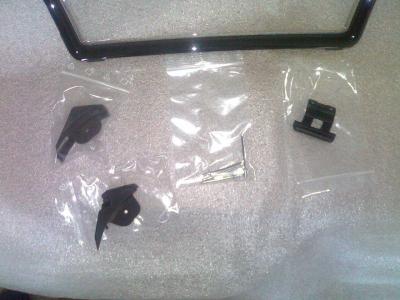

I bought the windstop kit and the riveter to install it myself, but i am not sure which rivet to use to for the attachment on the roll hoops and which rivets to use for the middle padding. i have attached a picture of the rivets that are in the kit. the rivets on the left have a darker stem and don't have a little knob thing on the end, the rivets in the middle in the picture has silver color stem and a knob at one end of the rivets.
in the kit i also found 8 pieces of plastic things, what are these for?
thanks everyone, just want to be clear before i start prying off the padding
SGT
I have not put in the 987 kit but I can figure it out. The rivets with the knob thing at the end are called open end rivets. Those I would use on the middle section of the roll bar padding, contrary to how willga did it. The closed end rivets that you say have a darker stem I would used for the 2 clips that are riveted to the roll bar hoops. The 986 windstop mounting kit only has the closed end type of rivets. Interesting that the 987 kit has 2 types of rivets. A closed end rivet does not permit water to seep into the rivet.
Those plastic things are bushing that go into the roll bar. They look just like the ones in my pic which is from a 986. When you pull the padding off the bushings may pull off the rollbar. You will see what those bushings are for once you get the padding off. They get damaged a bit when you pull the padding off, so they are included in the 987 kit, but not the 986 kit.
