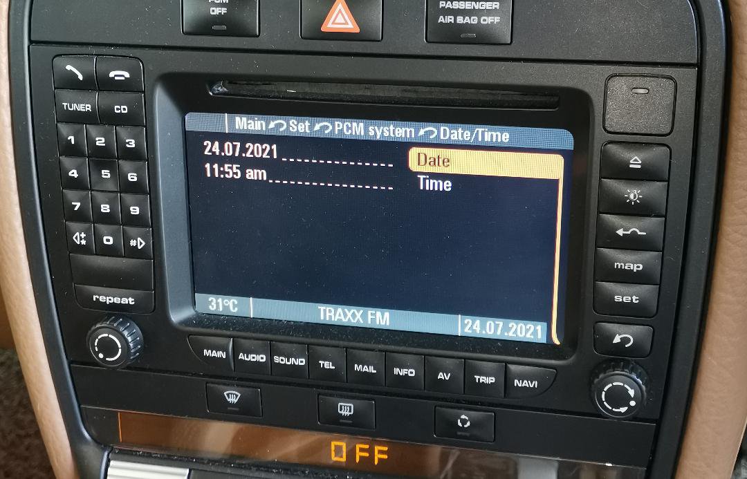

hi, i have removed all the 3 plugs behind the navigation (under front seat), so that i can set the date manually now.
but every time i start the car, the error message (CD changer & navigation system error) appears, how can i disable the error message ?

angusc, the issue was wrong date, and i could not set the date manually.
after i removed the orange fibre optic line in the navigation unit, i could set the date.
ya, i needed to re-plug the orange fibre optic back to the navigation unit, then no more error. tq.
