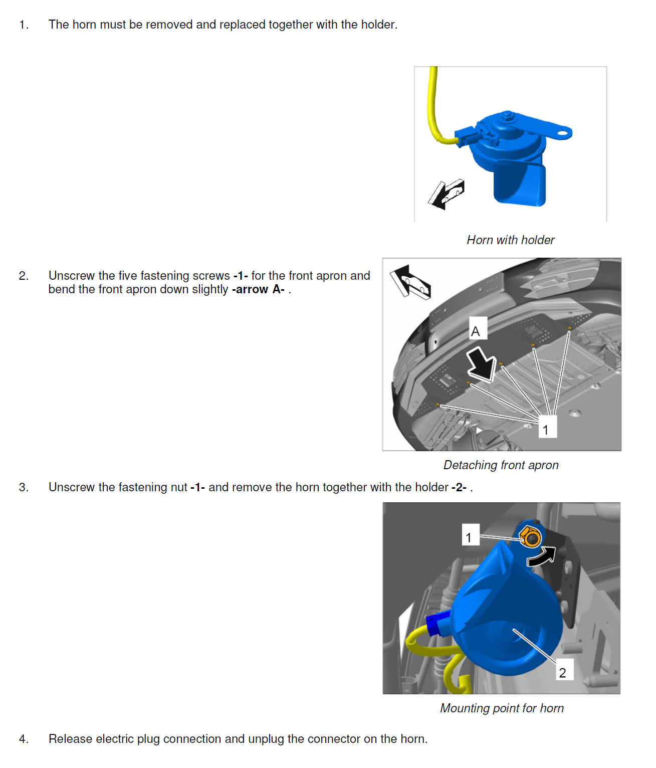

My 2013 Carrera S 991.1 had the low-horn fail. Now just the high-horn works and it sounds silly. Can anyone share the steps to replace the low-horn? Thank you!
