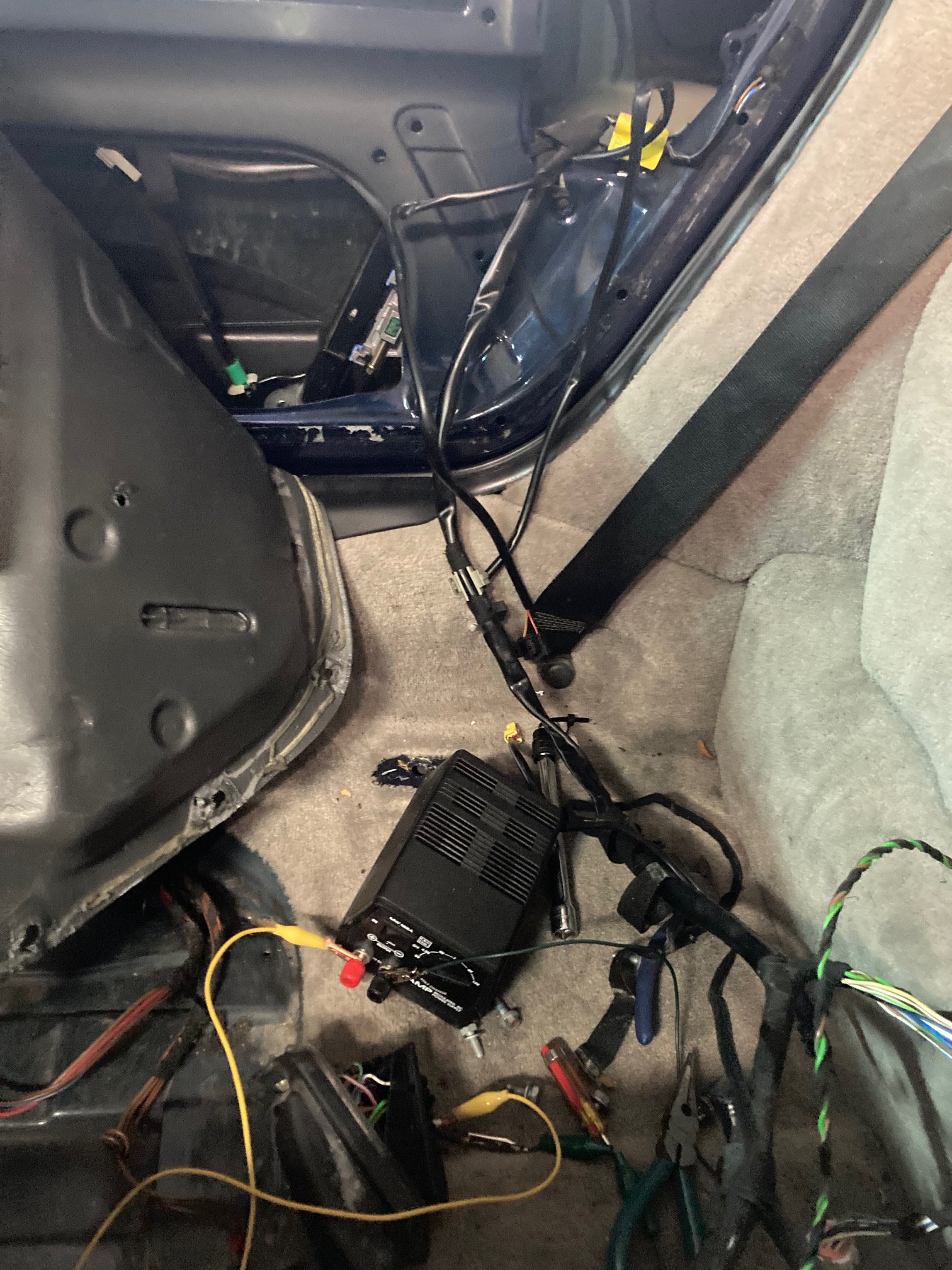

Hi All,
I replaced the passenger door lock actuator with an aftermarket unit, it worked for a couple weeks and then stopped working and the central locking had error codes in Durametric. At present I cannot open the passenger door from inside or outside. I managed to remove the door panel with the door shut and using a spare door wiring harness hotwired the lock mechanism with a 12v supply, I can actuate the lock this way - can hear the motor run briefly and a some door lock type noises - but it's still stuck closed. I have a known good lock I used to figure out the wires that connect to the lock motor. Leaning on the door while pulling the handle, pounding on it inside and out, disconnecting the outside handle - none of this worked.
I'm at the point where the only solution I can come up with to try next is to cut out the lock mechanism out by going in with a Dremel or similar tool. Any thoughts before I start that process? And if I do that, what do I need to cut? I have a spare lock mechanism (the old original broken one) and I've stared at it, not entirely clear what would have to be cut/destroyed to get it to open.
Thanks for any input!
In case anyone searches for this in the future, the Bentley manual wiring diagram is not correct for a 2003. I had to experiment with different combinations of ground/positive, eventually stumbled on one that worked and the door popped open.
