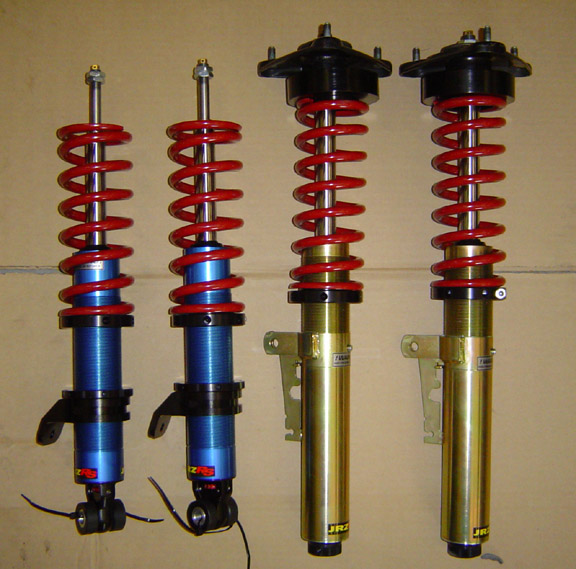

:) post-6119-1121030176_thumb.jpg

So what's the new deal? JRZ, whom for years has created remote reservoir shocks for track use has come out with a new shock, the JRZ RS double adjustable, that has similar dampening characteristics to is double adjustable remote reservoir shock and does not require you to cut your car to install a remote reservoir. The shock can be ordered with a similar spring rate as GT-3 stock springs, so it won't kill you on the street. The a set of four shocks with mounting hardware for my car sells for $3,500.
JRZ vs. PSS9 apparently the JRZ's can be dialed up to be much stiffer than the PSS9. In my driving of friends car's lowered with a PSS9 to ROW height vs. ROW MO30 kits, I did not find much of a difference in control, since I don't plan on slamming the car I was going to go with the ROW MO30 kit vs. the PSS9. Note - I have heard that with slicks the PSS9 kit becomes noticeably better than ROW MO30, but am as I am unlikley to run slicks this was not a factor for me.

P.S. I have attached a picture of the new shocks
