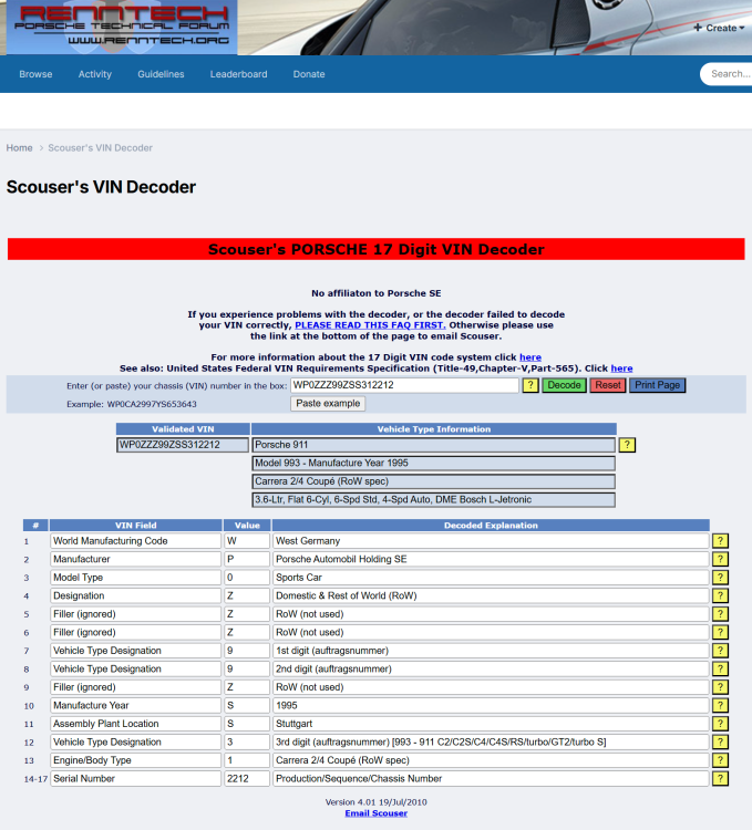

2 hours ago, Popsongs125 said:
Thank you so much Loren. Your great kindness helps me a lot. But out of my curiosity, for the Carrera 2/4 , what does it mean by the way ?
Carrera 2 is two-wheel drive and Carrera 4 is 4 wheel drive.
Not back then - newer cars specify a bit more but the best thing is to do a factory build database check.
I checked and your build code is 993330 which is a Carrera 2 wheel drive.
