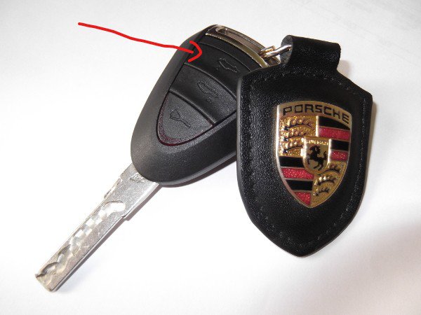

13 minutes ago, jose said:
Please let me know what function this button have
My 2005 C2S 997.1 key fob does not have the button you are pointing to. It just has the other two positions/buttons. Maybe your key fob is not original and the car does not support that fob button. I'm not sure.
I do have the cabriolet version with two original copies. I was guessing that was for the top roof, but I remember open the deck lid with key fob
Edited by jose
Since I'm third owner, I seems to suspect the car was previously coded and battery swap change some habits in the car
That could be. Also, when the previous battery was failing, its low voltage periods could have affected certain modules.
