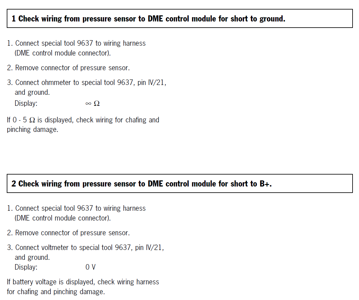

@Loren thanks for the welcome, I have read (likely all of) your responses on the subject.
First, are you saying despite "Short to B+" being absent on the code as read by every scanner, that short may nevertheless still be the issue?
Second, I'm at least 1.5hrs from the nearest dealer. Is there an alternative to the 9637 tool?
Not every scanner can read Porsche specific fault codes correctly. Only Porsche PIWIS tester or Durametric software can read Porsche specific codes to my knowledge.
For this fault, if it were my car I would definitely check for chewed or otherwise damaged wires and if none I would replace the sensor.
