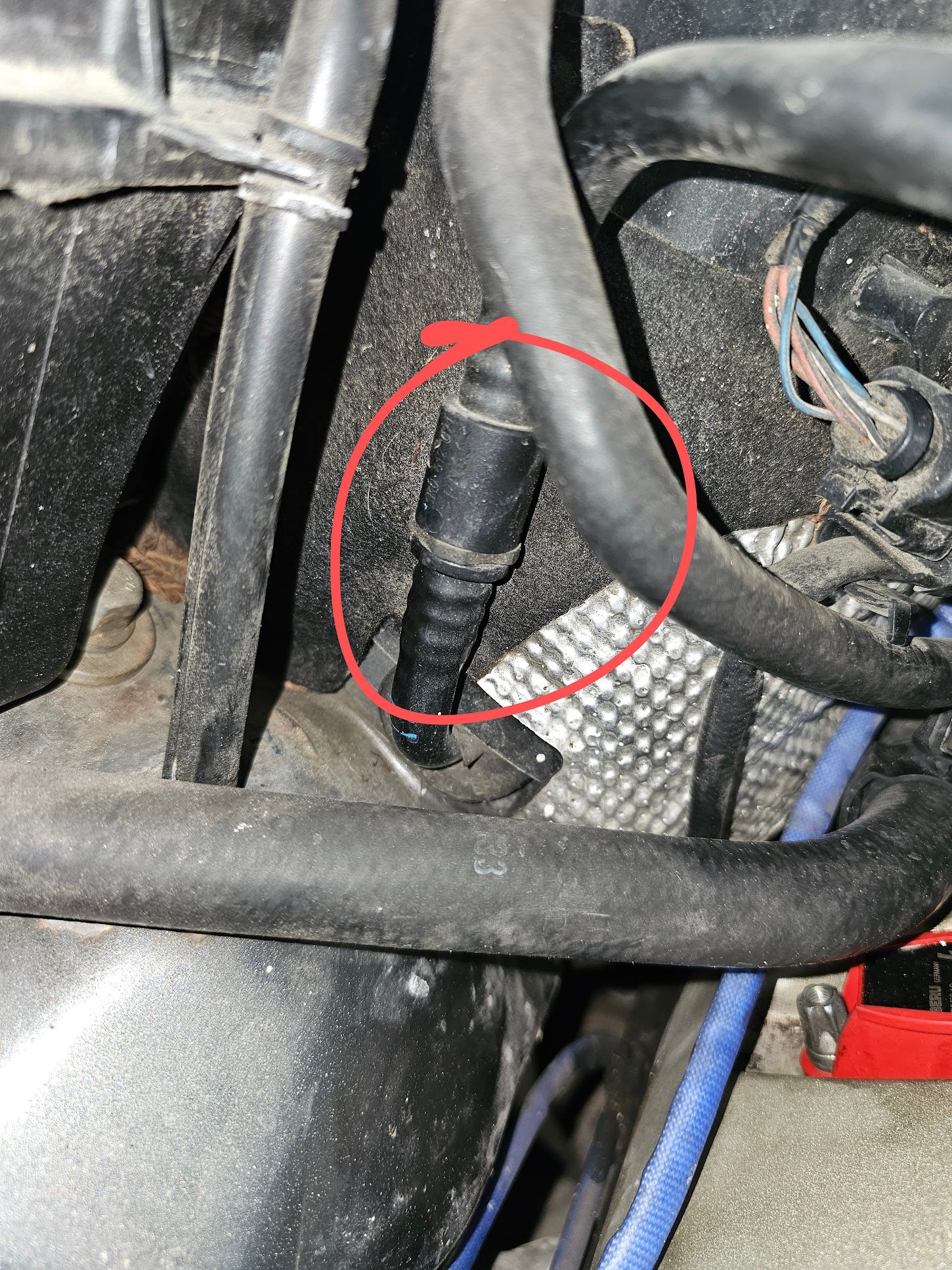

I'm working on my 2008 957 Porsche Cayenne S and I can't seem to figure out how to remove this brake booster line connector.
The part # is 95535557930, it sits in the passenger side of the engine bay right by the coolant expansion tank.
It doesn't seem obvious to me, and I don't want to force anything as I'd rather not replace the other end of the hose as well.
Any pointers are welcome, thanks!

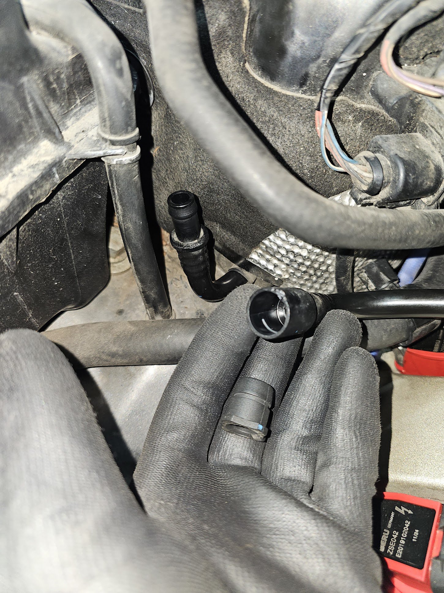

Like I predicted in the post above, it does indeed just "pull out". But you need to pull on it as if your life (or Porsche) depends on it, while making sure not to damage the bottom connector. It's tough because you need to hold the bottom part, but there isn't enough space to properly grip it. In my experience if you can pull it a fair way up you can then twist and turn it all the way off. Good luck to anyone who is changing this part and is having issues getting it off!
Edited by mathisve
Aha, that would have been easier! A pair of hose removal pliers will be a great addition to my toolbox. Thanks!

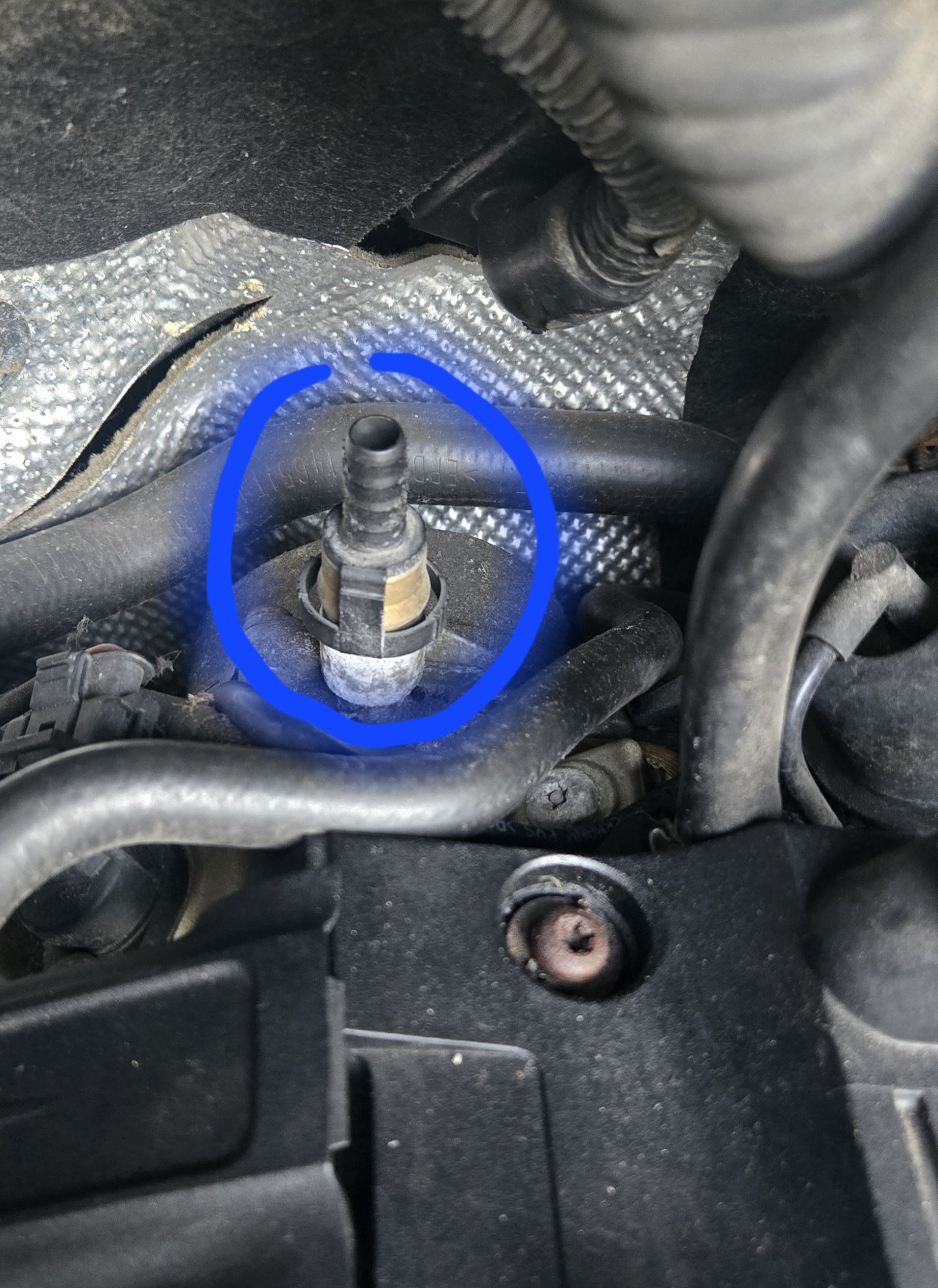

Non, push down with one hand, squeeze the ribbed bottom ring with the other hand and pull up, this is not as easy as it looks, succes.
Thanks, Ill try that. Truly, I was thinking about pliers to remove this...
