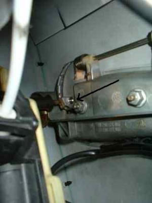

:beer: Solved problem of driver's door not opening from outside. There is a pin that connects the door handle lever with the lock action arm. The pin broke of just fell off. The solution was to attach them with a small screw and nut.
(Thanks "adsach" to for the panel removal info)
Attached is a picture of the handle from the inside. Hope this info can be used by others running into same problem.
