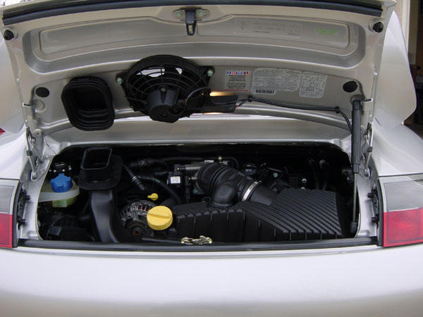

Here is a pic of the inside of my aerokit spoiler - note the only opening is to the air cleaner tube. The engine purge fan can cool by also bringing in outside - but only when the engine is very hot - and usually after stopping.
On the top side here is what it looks like.
