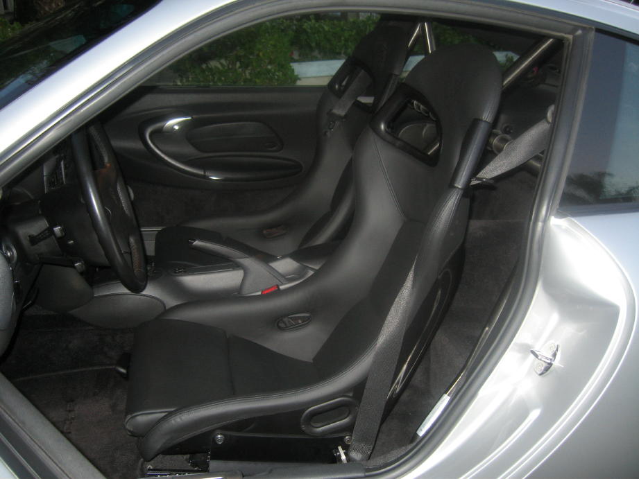

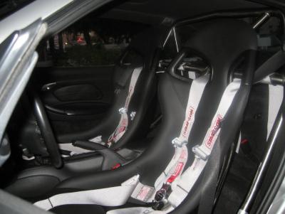

Here are photos of the seats in with and without the 6 point Simpson Harnesses .....
Edited by SMR996
Pics are up now...... They were too large and did not attach... :oops:
