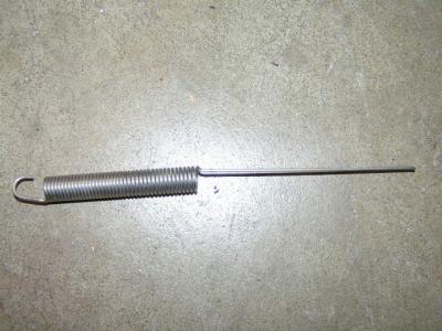

Here's the pic of the culprit. So if youu should here a tink noise when opening the door and the handle goes limp you'll know the problem.

Hey thanks your part # is right on the money. I have ordered the spring, but in the defense of Jerry riggin lovers like myself I stretched a couple of coils and bent a new curve at the broken end. This made it function as normal until the new one gets here or I guess until it fails again? As I am not looking forward to stressing my carbon fiber pulls again. Thanks again!
