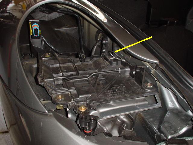

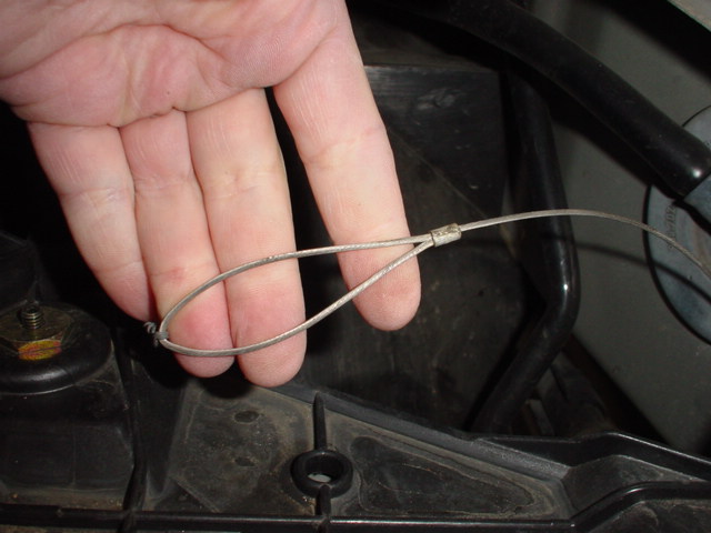

Any pictures of the cable? Like these? Which are of the emergency release cable on different LHD cars..
Or, did you pull on the bowden cable housing connected to the mechanical lever in the door sill?
It was the bowden cable that connects to the mechanical lever in the sill. This is where I got the idea from:

* Inside the top of the driver's front wheel well, just aft of the spring coil mount, is a little rectangular corner in the black plastic shroud that lines the inside of the wheel well. Reach under this, and you will feel a "wire" about 1/8" in diameter. Too thick for an electrical wire (and not in a harness anyway).
Now tug this cable gently out from behind the shroud and get a good grip on a loop of it. Now pull hard away from the headlight once, and prepare to hear the music of the alarm as the front hood pops open. Grab a 10mm wrench and take off one of the battery cables to silence this thing until you can get your key in the ignition and disarm the thing.
Disconnect the alarm horn, re-connect something with power to the battery leads, and unlock your car.
I did the third item - took less than 10 secs to locate the cable, and pull on it carefully (there's a lot of slack on it so you can get a good grip). Hood was open in under 30 secs... (actually quite a security risk on US Boxsters that don't have battery backed up alarms - never store anything in the front compartment!!!)
