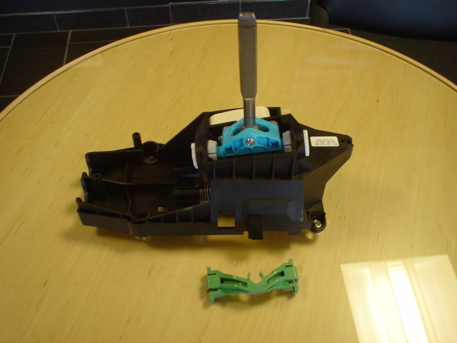

Your short shift has arrived in the parts department. I saw it today. Looks fast....
Since it has been paid for I might just try to pick it up. :D
Hey TP,
Do you work there?
Also, do you know what the green plastic thingies are?
Thanks - MK
Edited by markskessler
Just a groupie.
The green thing is just a tool to lock the shift lever in place. I have been trying to buy just the tool, but so far the only way to get it is to buy the shift.
When I mentioned the tool the parts guy said a shifter had just come in. So we looked at it because the shift tool use to be blue, not green, and there are part numbers on the back of the tools.
So now I have 2 part numbers to play around with to see if I can buy just the tool, but they are not tool part numbers. But he ordered me something.
