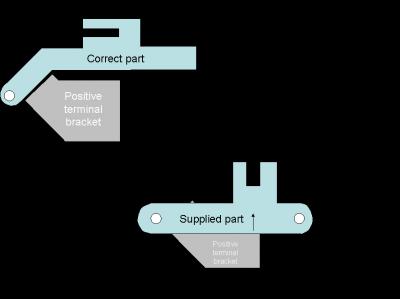

I've got the wrong vacuum holder in my PSE kit but it hasn't got a part number in the TSB.
Any one know the right part number for the holder? Its the bracket which fits over the positive terminal in the engine bay and has an angle on it taking it at 45 degrees up from a mounting point to over the terminal, then horizontally over the top where the relay is mounted on it.
Tim
Here's a drawing of the two parts (attached). I've got the one on the bottom. From the pictures posted on renntech and the like (and thanks - yours too!) the actual part looks like the one at the top.
It really does not matter where the vacuum switch is mounted, though it looks like this sort of bracket is used somewhere else in the car. Must have been packed by mistake.
The P/N of the correct bracket is 996.111.989.00 and is called a "Holder ->Electric change over valve.".
You might see if whoever you bought the kit from will get you the correct bracket.

Thanks Orient. The people I bought the kit from didn't know the correct PN, nor did their supplier, so this should help!
