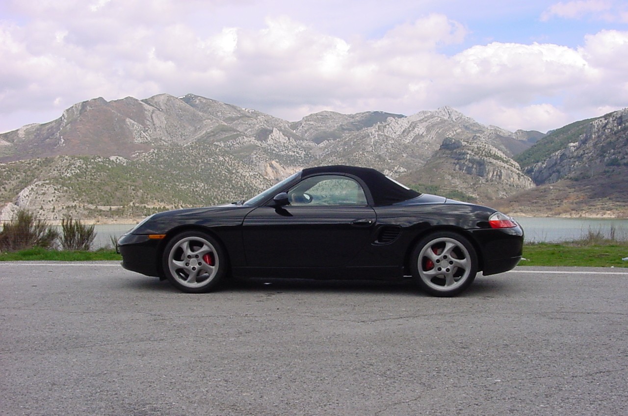

I run 18's on my MY97. I dont race it on track, I do ride it a bit hard near the mountain roads, but not too hard. The car seems fine. It looks great (Carrera 5 spoke) light wheel (atleast in my mind). Check my garage for pics.
I also had read that there was a reason not to put 18's but I figured that if I did not change the overall volume of the 17 with the 18's it would be fine, I also looked for what I thought were the lightest wheels.
I say put 18's, its much nicer and car gets a slight mean look.
Let me know when your cars falls apart so I can come over and look at it. :P
