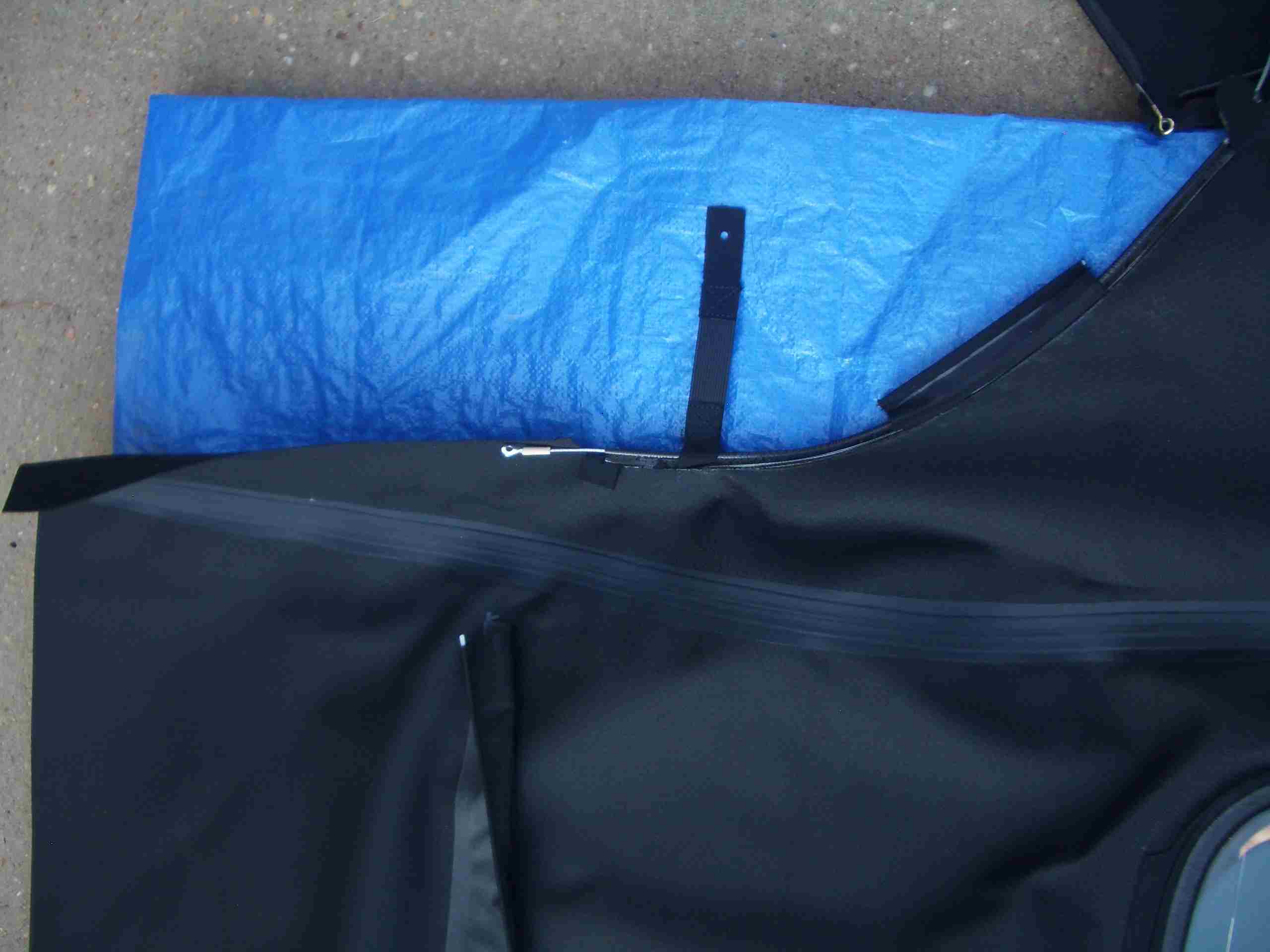

On the slider-picture, the left parts is what I bought new, the right parts (longer) are what came out of the vehicle. My feeling tells me, use the longer slider. My brain tells me, use the newer (shorter) slider as Porsche did not develop it without reason.
I also included a picture of the new top where you can see those elastic strips. GAAH tells that they should be
fixed to the third bow from the front.

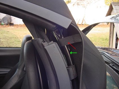

Definitely the right move with the white plastic ball cups.
I am also glad to see that you did EXACTLY the right thing with the foam seals. That's the way they came with my top (it was a factory top that I bought on eBay from a guy who had bought the top and totalled his Boxster before he could have it installed). The top came in a Porsche box, with Porsche part numbers and it included a kit that included the foam seals, and they had adhesive on one side . You will have no problems with leaks that a few posters have reported when they "skipped" installing new foam seals.
The photos of the sliders tell the whole story. I would definitely use the longer sliders. That's what came with my factory top and it worked out perfectly. The part that extends 1 inch higher at the upper end helps insure that the cable falls better into the guide channel.
If you look carefully at that post #24 in the thread I gave you a link to, you will see the difference between the two versions of the 'short' sliders. Those are versions 1 and 3(call them "old" and "newest". The longer slider is version 2 (call it "newer"). The difference between the old and the newest versions is the spacing and location of the channel at the bottom of the slider. You can see the difference in the measurements and photos that "Jimmyboyle" posted in that thread.
The elastic straps provided by GAHH appears to be correct for insuring that the top folds correctly and also to help with the cable falling into the guide channel. Since you have your top in front of you, it might be helpful if you compare the location of that elastic strap with the measurements I specified in that same thread.
Let me know what you find, but my instinct tells me you will be okay with these elastic straps and the longer (newer) slider that was originally installed in your old top.

"I also included a picture of the new top where you can see those elastic strips. GAAH tells that they should be
fixed to the third bow from the front."

Mike:
On an OEM top, the elastic strip is attached (sewn in) to the top canvas and piping. There is nothing that should be attached to the plastic female receptacle that juts out from the clamping rail/slider assembly or from the plug that is pushed into it.
Go to the write-up I did on Mike Focke's web site on getting the cables to fall into the guide channel and you'll see some pics of that section http://mike.focke.googlepages.com/converti...fallintoguidech
Here is one of the photos from that write-up:
