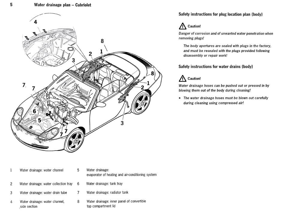

There are other drains in the back on a Cab. Take a look at this: http://www.renntech.org/forums/index.php?showtopic=7791

The common leak in a 944 that you mentioned doesn't actually leak into the rear of the car. The drains under the rain guard at the base of the windshield get clogged than the water begins to rise. Eventually the water reaches the fresh air vents and pours into the climate control system. Your leak is most likely the result of the drains in aether side of the car becoming clogged. You can access them easily by looking for the holes as a friend operates the top.
