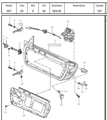

Paul:
It's because the microswitch in question is INSIDE the door lock assembly (Part #14 in your diagram).
There was a thread here yesterday or the day before that actually had a photo of the overall part, even though that particular new part may have been defective. If I find that thread, I'll post a link here so that you can see the part.
Since you have confirmed that you are getting the same result from inside and from outside, it probably is that third microswitch. Sometimes you get lucky and it's just a loose connection to that switch.

The story says he replaced part 14 and it did not
fix his problem.
