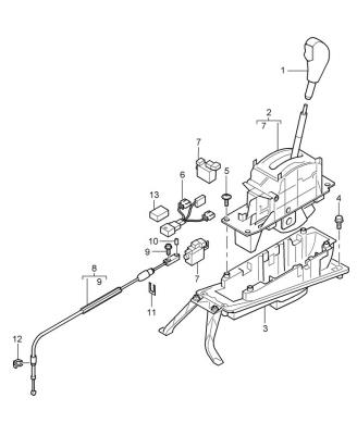

Well, now I am stuck....  Your replies make more sense to me, as does another one that I got relating this to the solenoids, but the dealer just called and told me that the reason for my issue is directly related to the cable that connects the shifter lever to the tranny itself.  They claim that they "temporarily fixed it with a pin and some washers", but the cable needs to be replaced.  They even managed to drive the truck to another lot they have with this fix.  As per their claim, their "hack job" can last 1 day or 100 years, they just don't know.  Their repair quote came in at $228 for the cable and $338 for labor to replace it.
Any idea what the part number for that cable is?  See the exploded view below.

Found the cable in USA for $160 and the ex head mechanic at the local dealer would charge me $250 to replace the cable.  Just posting this for future reference in case it helps someone later on.

$138 at porscheoemparts.com
part number is 95542603311
