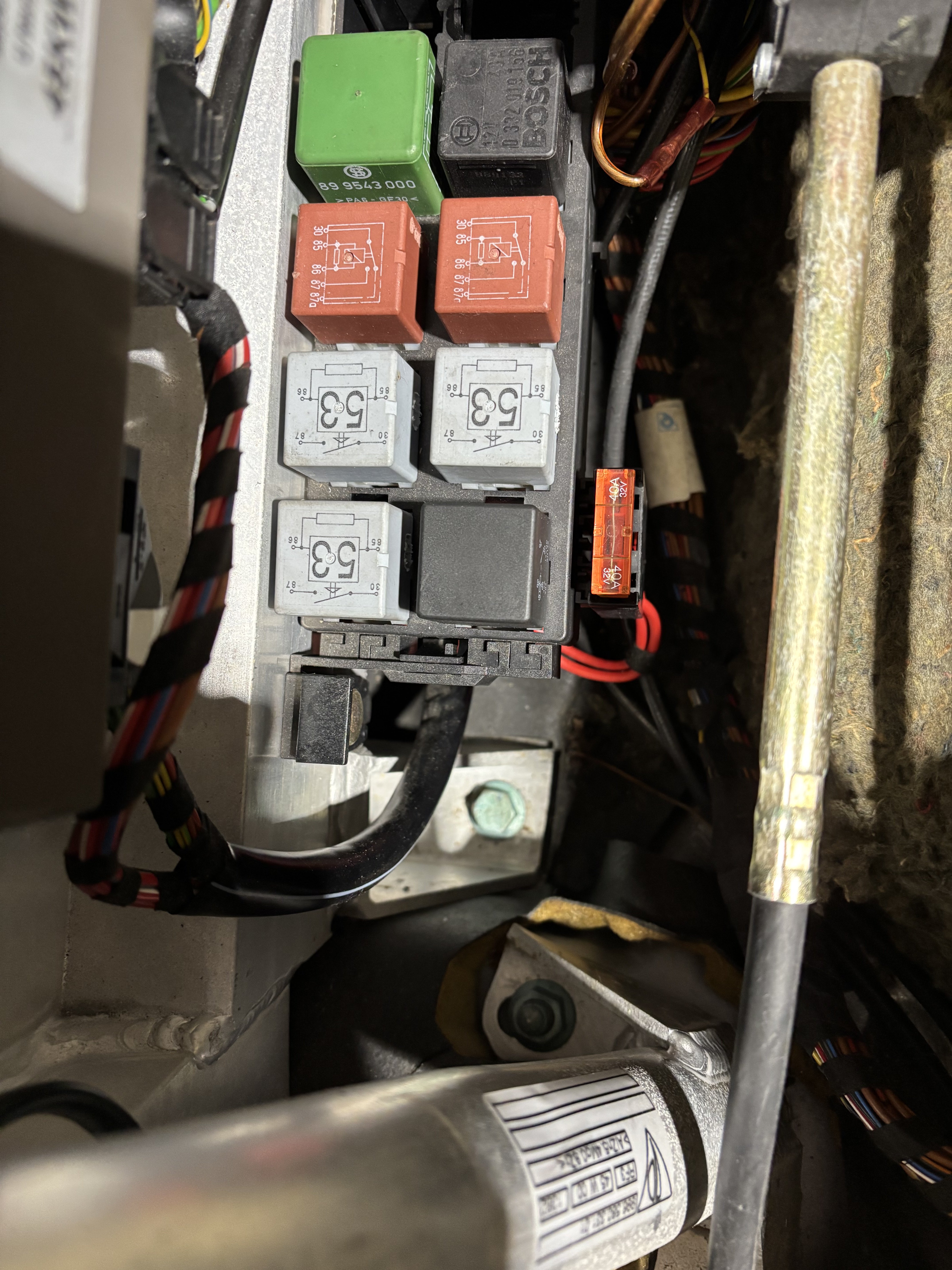

  3. When I see cabriolets' with starting problems the first I think of is the immobilizer box under the passenger's seat. These are prone to flaky operation once they have gotten wet. I would remove it and open it up to see if there is any sign of water damage.

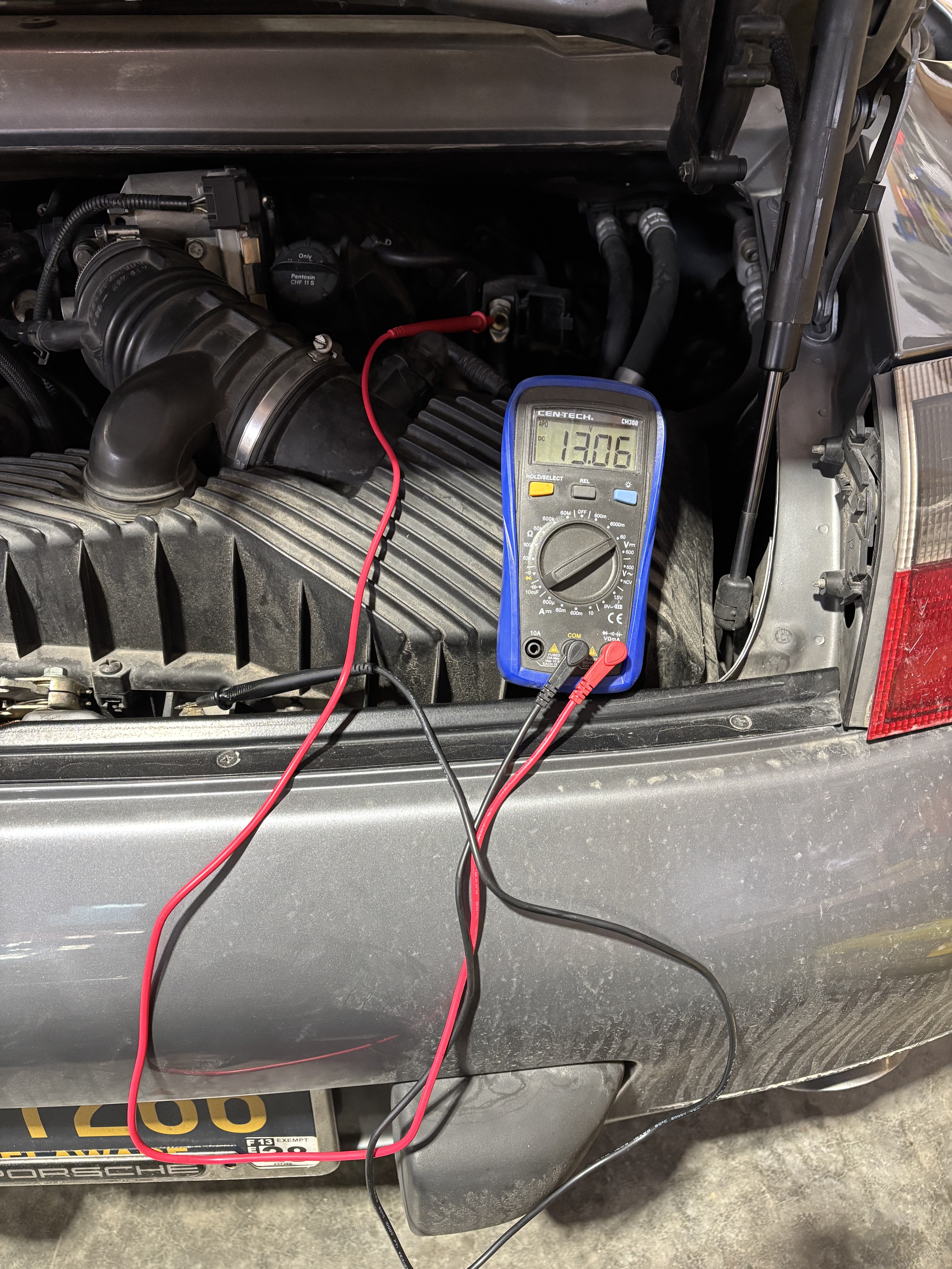

  4. Today, I checked voltage at the battery and also at the post in the engine compartment. There is no voltage drop noted. Note, I had just taken the battery off of the charger and measured the voltage in the engine compartment first which will explain the higher voltage coming from the engine compartment. Yes, the charger was off although still connected. ….And, the car did start again today with the relay bypassed…
  5. HI, I previously reported that my starting issue was solved. It’s not, and now the car won’t start unless the relay is bypassed. I originally swapped out the starter relay, and same problem came back as evidenced in the video. I purchased an aftermarket relay and installed it. That worked for a few days, and then stopped working. Now, I can only get the car to start if I bypass the relay. I thought if bypassed the relay, then a replacement relay would be the solution, but that did not work. Where should I go from here? IMG_3505.mov Aftermarket relay below: Car starts when the relay is bypassed: Where should I go from here?
