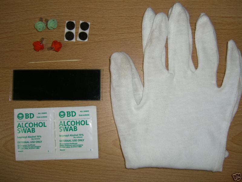

The a/c control unit is from an Audi. The LCD display goes bad. There is a guy selling just the LCD for Audi. I asked if it would also work on a Boxster and now he sells it as an Audi/Boxster LCD. But I do not know of anyone who has actually tried to replace the LCD on a 996/986. If you want to give it a try or donate the defective display to me and I will try it - let me know.

Here is the ebay LCD display. http://cgi.ebay.com/ebaymotors/ws/eBayISAP...1748&rd=1,1
2 Boxster owners have tried this LCD replacement without good luck.

I contacted the seller a few days ago to find out what the issue was, and did not get much of a response other than the statement that someone has done it.
My a/c display is fine. Hoped someone would figure out a way to fix the LCD since it is a common problem.
