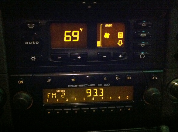

I had a similar situation recently. I had an old CR220 radio with peeling buttons. I also had another CR220 with a bad LCD display. I dissassembled both, took the good parts, and built one good working faceplate.
Interesting note: The bad LCD display in the CR220 was caused by the circuit board inside the faceplate housing. By swapping LCD's, zebra connectors, and circuit boards, I was able to deduce that only the circuit board was bad. (I cleaned all connections, so it wasn't from dirty connectors)
Before:
post-56687-0-24588900-1334348989_thumb.j
After:
post-56687-0-42324800-1334348995_thumb.j
Note that I repaired my climate control display at the same time using this DIY.
