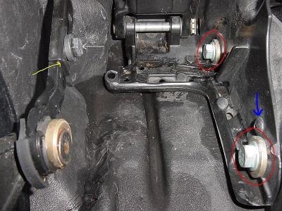

1. Put the top in the service mode (if you are not sure how to do this, it's in the owner's manual), and make sure the clamshell is at it highest position (45 degree angle, as far back as possible). Unlatch the black/gray vinyl apron from its two plastic retainers on the rear firewall and pop off the two tension cables from their steel balls at the base of the cables. Now, reaching under the B-pillar round black knuckle at its base, pull off the white plastic cups (maybe red plastic if yours have never been replaced) from the steel balls that they are pressed on to. If you have too much trouble popping those off, you can undo the 10mm bolt (with thick washer) from the middle of the connecting arm that leads to the white plastic cups on one end and the front of the V-lever on the rearmost end of it. Before you undo that bolt, mark the point where the two halves of the connect arm are joined so that you don't have to guess at the correct length later. I have attached a photo, where the white arrow shows the 10mm bolt with thick washer. The yellow arrow shows where you should mark the position of the two halves of the connecting arm. The red circles show two of the three large bolts that must be removed (see step #3 below)

3. Unbolt the 3 large bolts that are visible on the backside of top frame, looking under the rear of the B-Pillar while the top is in the service mode. Some Boxsters have a plastic box covering these three bolts, and this plastic box comes off with removal of two Phillips screws. The large bolts are self-centering, so it will not be difficult to re-install them in the correct position. The top, with the mechanism attached is still very light, but it is a little bulky, so you might want to have someone help you lift it off.
4. You may find two Phillips screws just ahead of the rearmost large bolt (the first one is visible in the photo indicated by the blue arrow) on each side. Unscrew those Phillips screws and set them aside for later reassembly. You may also have to gently separate the foam liner from the metal bracket that has been pressed on for many years. Proceed carefully to insure that you do not rip, cut, or tear the foam liner.

Does anyone have a picture of the white or red caps mentioned above or can describe where they are suppose to be located? My drip pan is torn and leaking and in the hole I found a white plastic cap but cannot determine where it belongs. Are these caps necessary? As I do not yet see one on the passenger side either.
I apologize for the crappy pictures but hopefully someone can tell what this is and explain to me where it goes:
Again, I found this in a hole in my driver's side drip pan and am concerned with how it got there and if it is needed. I'm trying to repair the drip pan now.
The white part in your pic is the (broken) ball joint which is mounted on top of the left rod (with the yellow arrow) and connected to the top mechanism in the B-pillar area when closed.
I have verified that both ball joints are in place on top of the driver's and passenger side rods. Perhaps one broke on the previous owner. Thanks
