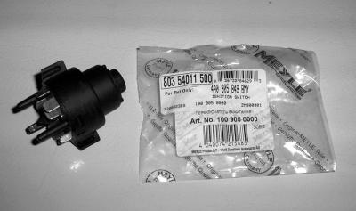

I dismantled the failed switch and sure enough there was a little piece of plastic which had failed and no longer held the return spring in place - exactly as shown in a photo I found in another renntech post.

Here is my spare switch:
