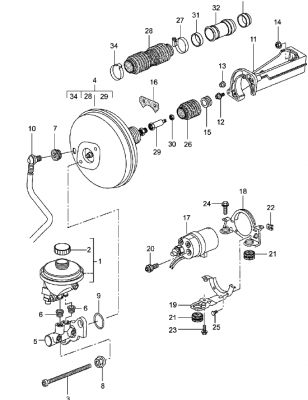

  12. The brake booster vacuum line is the front on the booster. Item 10. I really can't recommend running Seafoam through a 996 engine -- but it is your engine...

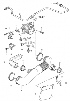

  13. Your diagram is the air injection circuit. IAC is not part of that. The IAC (item 3) in on the throttle body. Do not damage of lose the paper gasket item 16. Yes, sometimes it helps to clean it with carb cleaner. The metal window inside should turn easily. While you are there I would cleant he throttle body and throttle butterfly too - especially the backside of the throttle butterfly. As I said in some cases the solenoid fails and the valve then needs to be replaced.
  14. P1123 Oxygen Sensing Adaptation Area 1 (Cylinders 1 - 3) - Lean Threshold P1125 Oxygen Sensing Adaptation Area 1 (Cylinders 4 - 6) - Lean Threshold These codes mean that the DME can not adjust a too rich mixture (it has leaned the mixture as much as possible but can't correct it enough). PI551 Idle Air Control Valve Closing Coil - Open Circuit Potential causes: - Break in wiring. - IAC valve faulty. - DME control module faulty The Idle Air Control Valve sticking could cause a too rich condition that codes say they saw. I would remove and clean the IAC and make sure it is moving freely. In a few cases the solenoid on the valve fails and it then needs to be replaced.
