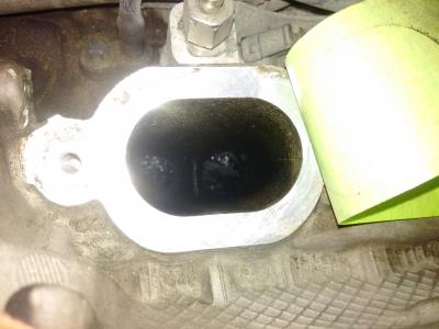

  5. The pig has 200km, I bought it from a friend with the CEL cam code on (I'm the 2nd owner). Mobil 0w40 services every 10-15K, I just changed it to Liquid Moly 10w60 RaceTech (runs better, doesn't burn). The crazy thing is he said this light was on since almost the beginning when he had it serviced at the dealer for something, which made me believe that it was a bent reluctor ring on the cam, but it looked good? I don't know.... this is why I asked if anyone has had any similar experiences with this. I have almost 20k in receipts since the beginning so I don't think it's been neglected.UPDATE :I recently got my Cayenne back from the shop & I want to report that my issues have been solved. The tech confirmed that problem was with the cam timing (both banks off) & proceeded to re-time the engine by locking the cams using a special fixture& re-adjusting the cam sprockets back to factory spec. While the intake manifold was off he carbon blasted the intake & replaced the plugs. The result.....no more engine light, smooth start up, quick snappy response & smoother transmission shift. Happy customer!
  6. Hey Cterry77,I've been waiting to post this, I just got my Cayenne S back from the shop (same year as yours). My issues were a cam code (bank 2) which came back immediately after clearing....caused a weird starting issue (crank/stop...crank/start) & a slight reduction in power. The shop traced the faults to the timing chain being out of sync. They took the intake manifold & valve covers off & re-timed the engine using special fixtures to lock the camshafts in place. Both banks were out of sync, since the intake manifold was out they carbon blasted the intake valves. Got it back and WOW, what a difference. Loads of power, transmission shifts better, no more starting issues. I forgot just how beautiful this engine really is.... I'm not saying that you're problem is the same as mine but my issues were solved :)
