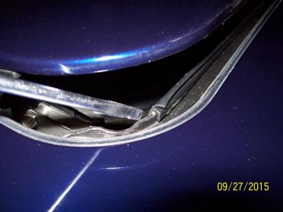

  13. Here is what I found on my '01 that had a sunroof rattle only when the roof was open. Operate the roof so that it is tilted, and then look along the back edge of the frame. There will be a drip pan that is spring loaded, and a weather strip piece attached to it. If the weather strip is missing or just laying there in the drip tray, the drip tray will move up and down going over bumps and make a bad rattle. See pic- the screwdriver points to the drip tray, and you can see the rubber strip in place. Clean up the pieces, glue the weather strip piece back on, and the rattle should go away. My roof is silent now!
