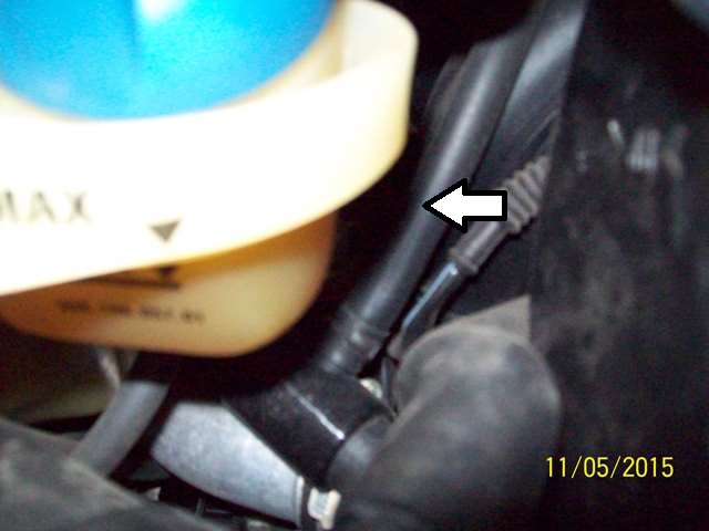

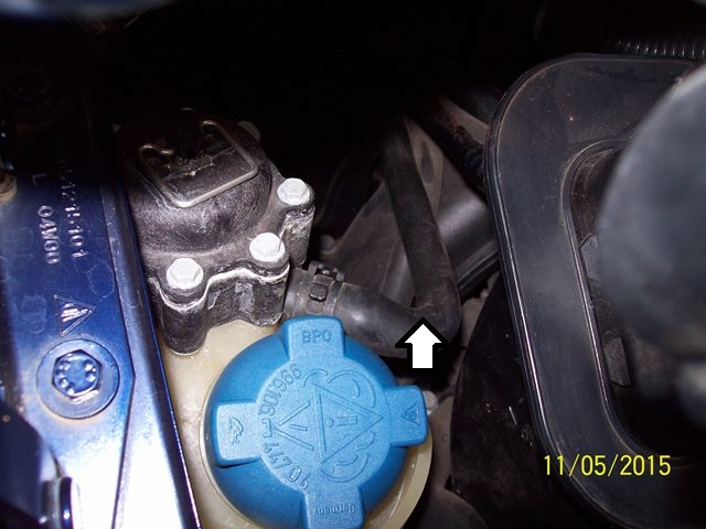

  10. After going through all the hose diagrams and pulling out the recovery tank, I figured this out. The hose with a 90 that connects just below the breather valve is the vent hose that comes from the oil cooler. The hose that goes to the 'T' is a return hose from the AOS. So to find the part numbers you have to go to the AOS and oil cooler parts pages.
  11. 2001 C2- I'm replacing coolant hoses but cannot ID the two shown in the attached pictures. Both hoses run to the back of the engine. The hose that comes off of the "T" (second pic) attaches to hose 996 106 580 00 (05) but I cannot find anything in the diagrams. Thank you.
