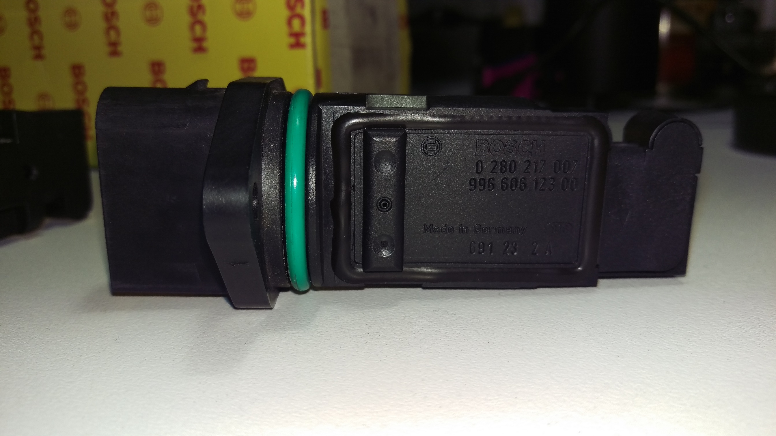

  1. Hello; I had 3 pieces of MAF for 996 3.4Liter Porsche's. I can list one of it on Ebay if you want.

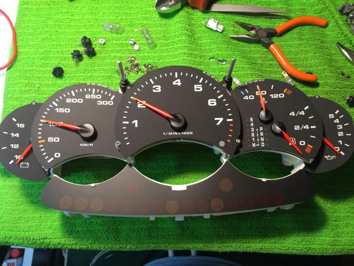

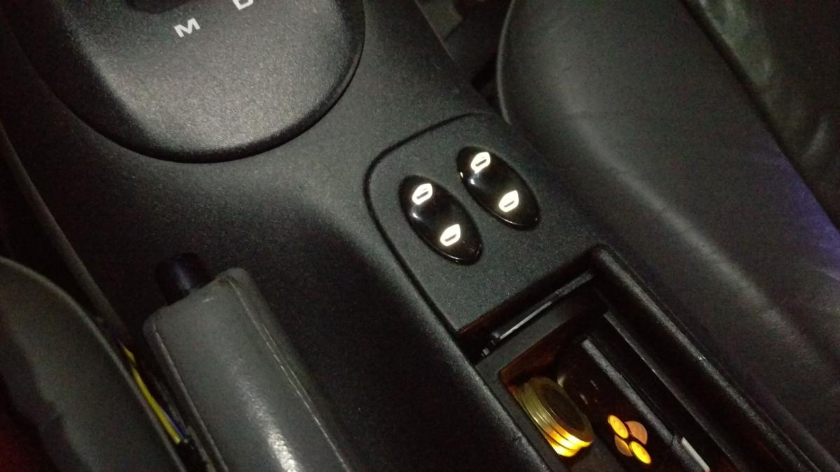

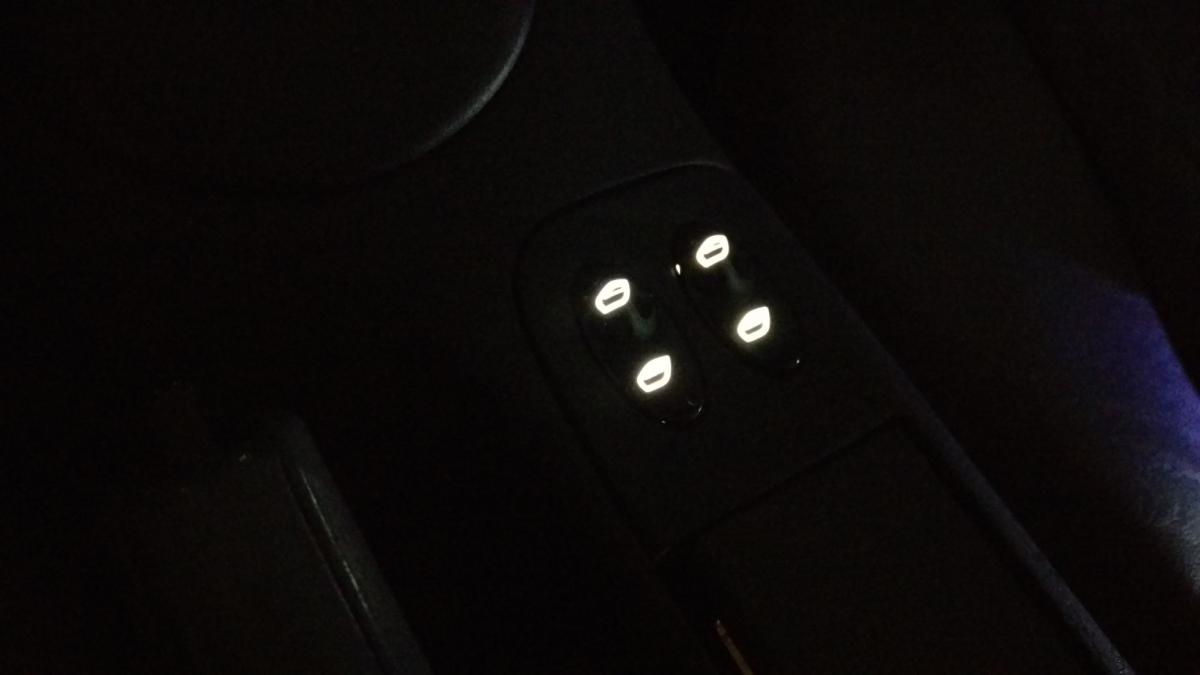

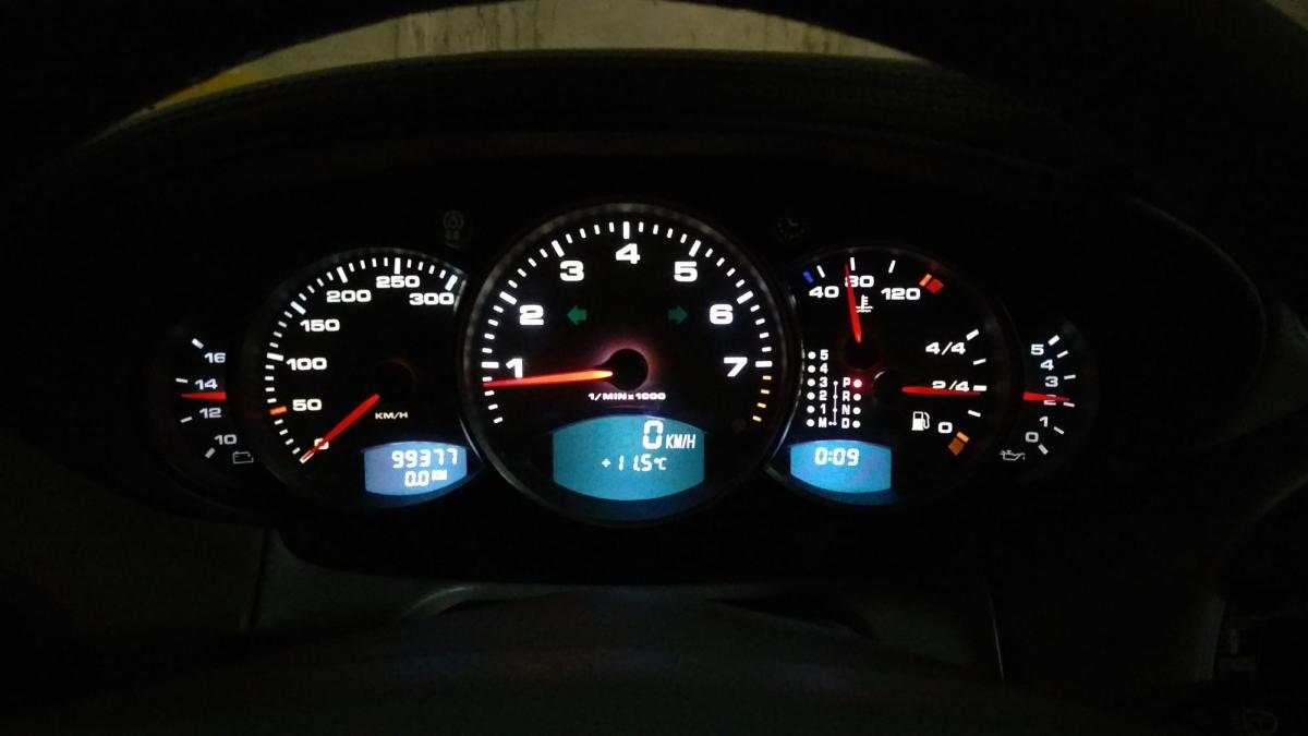

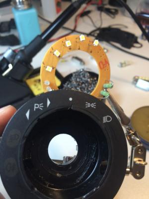

  9. First of all; thanks to "TabooPc" for the idea...(From another forum...) My car is 1998 Carrera2... Instead of his cluster; mine is older and has previous technology I guess. My inst. cluster is feeding with Halogen Bulb instead of his gauge. So when I changed these bulbs; it was completed. (Because of his post; I bought 100 pcs of leds ) As an extra; I changed all the switches and the others led's from Amber to White. Conclusion is very good for me; total 36 hours of works. (I removed the gauges, speed, rpm, fuel etc; then I missed to put sign so I spent 4-5 hours to fix them ) Here is pics; if you need info; you can ask me... Old Style original amber.... Final result...
  10. here is Cruise Control Bulb; it is 1.5 watts (white dip) black dips are 1.2 watts
