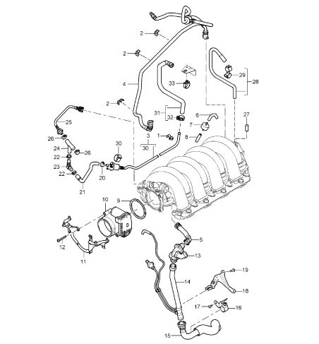

  8. Hey all, Has anyone replaced the turbo vent line from the 5-8 side? I am chasing some boost and oil consumption issues and and found that line broken. I am concerned it will require some surgery to get to. Is it possible to get to without removing much? It looks like its tight against the turbo and I am unsure I'll be able to release the connector or install the new one with out dropping the turbo. Thanks for any help Mike Part number 94810721651, #15 in the parts diagram
