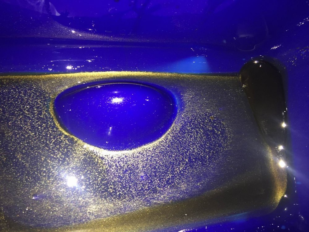

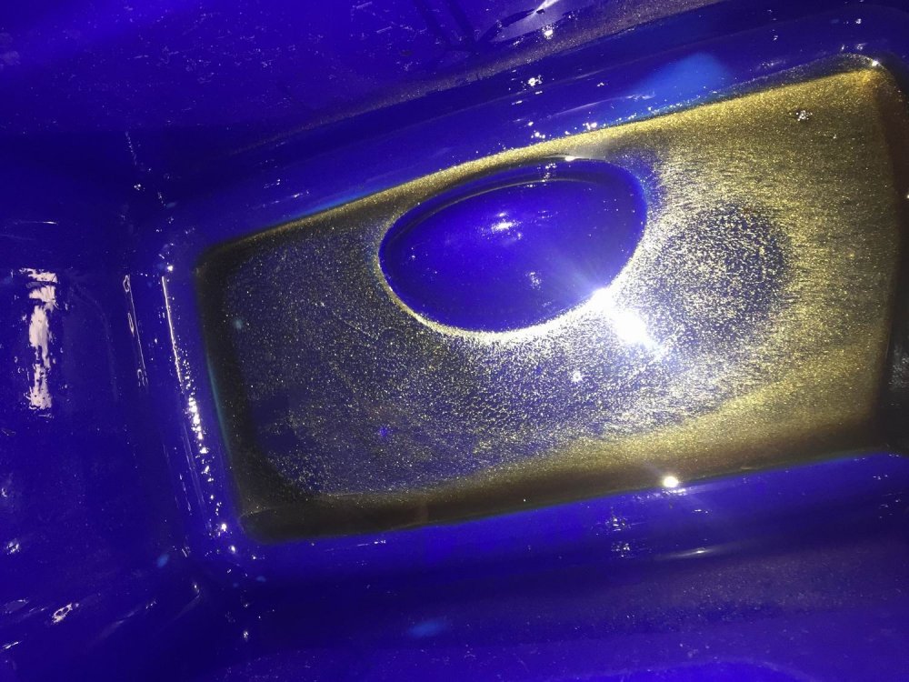

  9. So guys, It is unavoidable that I must change bearings in the differential. I went to the gear-specialist and he explained the problem of this final drives. He saw the pictures I posted and he will do a "differenatial revision". It's an expensive job but it is worth I think. Greetz

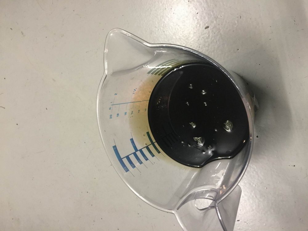

  10. Hi to everybody. After crunchy grind noise from the front axle I thought it's time to change both final drives oil of my CTT after 165'000kms (about 100'000mls). Please note that you have to use different oil for front axle final drive and for rear axle final drive, and it depends if the rear axle final drive is with or without differential lock. I used porsches orig. oils... 000 043 305 04 for front axle (replaced by Porsche for the old 000 043 205 30) and 000 043 300 37 for rear axle (with differential lock). If your Cayenne has no diff/lock you have to use the front axles oil. Now back to my recommendation... I'll not say anything, I only show you the pics of the old oil drained out of the front axle final drive..... I think it's not nice for the diffs to drive with this kind of oil
