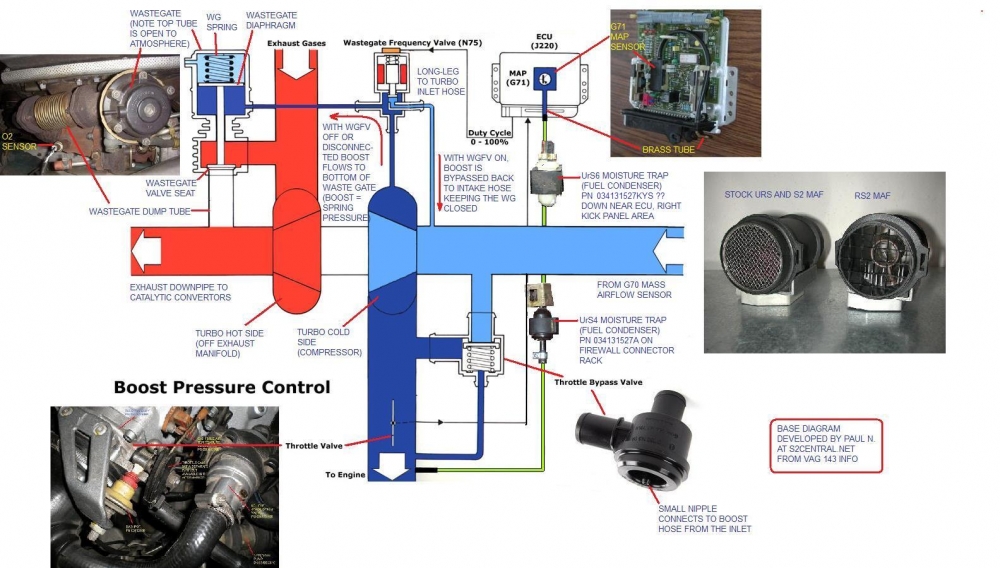

  16. Thomas, this is a great diagram to explain how this system works (originally from Paul N. of S2Central.net). It’s based on a VW system so pretty much the same as ours. The “hot” side of the turbo is the one with the turbine, named obviously as it is spinning from the hot exhaust gases. The “cold” side of the turbo is the one with the compressor, which compresses the air coming in from the intake air filters. The diagram shows how this works; when boost is turned on, pressure from the output side of the cold side of the turbo (so the dark blue compressed air region) goes into the N75 valve and is dumped back into the cold side before the compressor (light blue). So if you blow into the one that goes to “atmosphere” (the light blue side of the cold side), it will blow out the air box. If you blow into the line to the N75 that goes to the compressed air side of the cold side (dark blue) it will have a bit more resistance when the engine is off, but pressurized air will blow out of it if the engine is running (which you wouldn’t want to do!). When the boost pressure gets too high the N75 valve opens and sends the pressurized air from the compressed air side of the cold side of the turbo to the wastegates to open them. In practice it doesn’t actual just open, it pulses very fast to maintain a certain level of pressure to the wastegate actuators. So if I am reading correctly Thomas, you have restricted the line that goes to the dark blue, compressed air side of the cold side of the turbo. This is the line that provides the pressure to open the wastegates, so in fact it should actually increase the chance of an overboost condition. Let us know how your tests go!

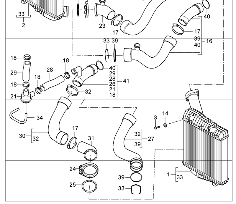

  24. Number 39 on mine (2004), I think 25 is an alternate version on newer models.
