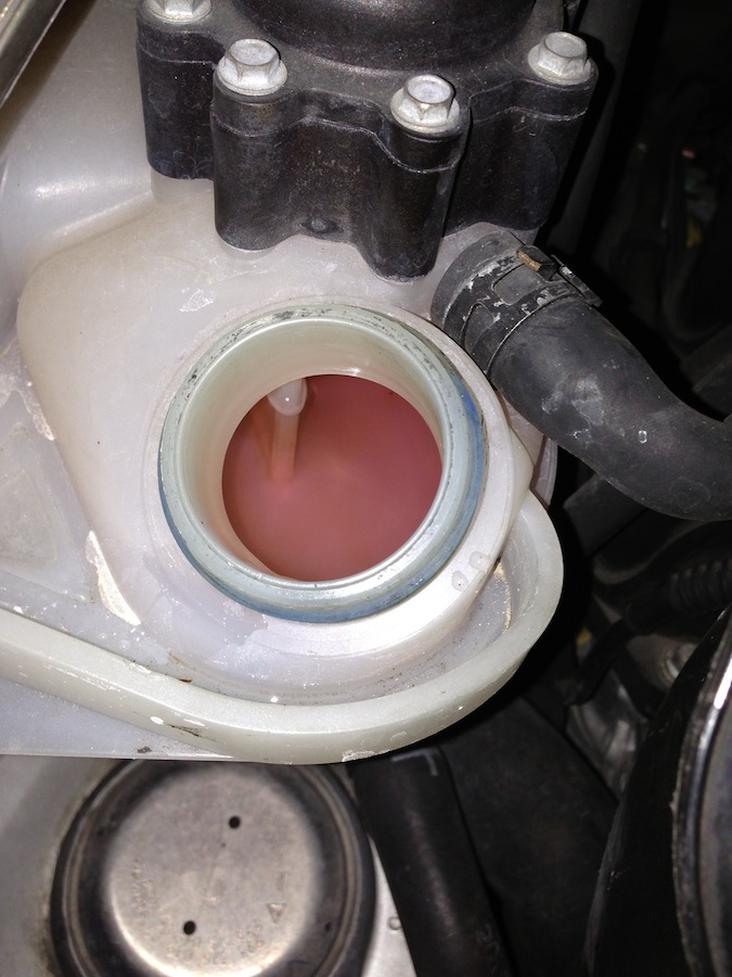

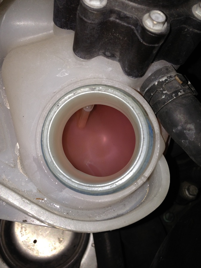

  17. Hello all! Happy to report that I just turned the car on (twice) after a ±5 hour rest and neither time did any smoke come out! I believe that the little smoke I saw earlier today was due to the "Italian Tune Up" I had done and nothing more. I also took a couple of pics of the reservoir tank and it looks identical to the way it left the dealership three days ago. See for yourself:
  18. Well, my joy didn't last too long... Today I took the car for a very spirited drive (80-120mph, maybe 10 times revving all the way until it automatically shifted, ±30 minutes) and then I drove for about 10 minutes at a very conservative 40-50mph to "cool things off". Parked it for about 6 hours. Just went to run an errand and when I started the car up, smoke out of the right muffler. Because my car is parked in a dark spot I could not tell if the color was white or blueish. It was not much, but there was definitely smoke upon startup.Going to wait for the car to cool off completely so I can open up the expansion tank. IF I have intermix, would the color of the coolant change immediately or does it take days for it to turn from pink to brown? Perhaps this is the normal smoke after spirited drive? What concerns me is that it only comes from one side (right).

  22. Just an update: picked the car up and the expansion tank is now full of pink Porsche coolant/water (50/50 mix). They kept the car for a few days and confirmed that it does not smoke upon startup and readily admit it is most likely due to their mistake in overfilling. They claim to have taken all of the air out of the system and confirmed that in fact it will hold a vacuum and no leak. Their only observation is that they found it odd that it seemed as if no coolant was in the old water as it just seemed like plain water with no coolant mixed in. Only time will tell if there is intermix or not. I am not complaining of the fact that it looks fine now and that the car no longer smokes upon startup. Thank you all for your advice and here is to keeping fingers crossed!
