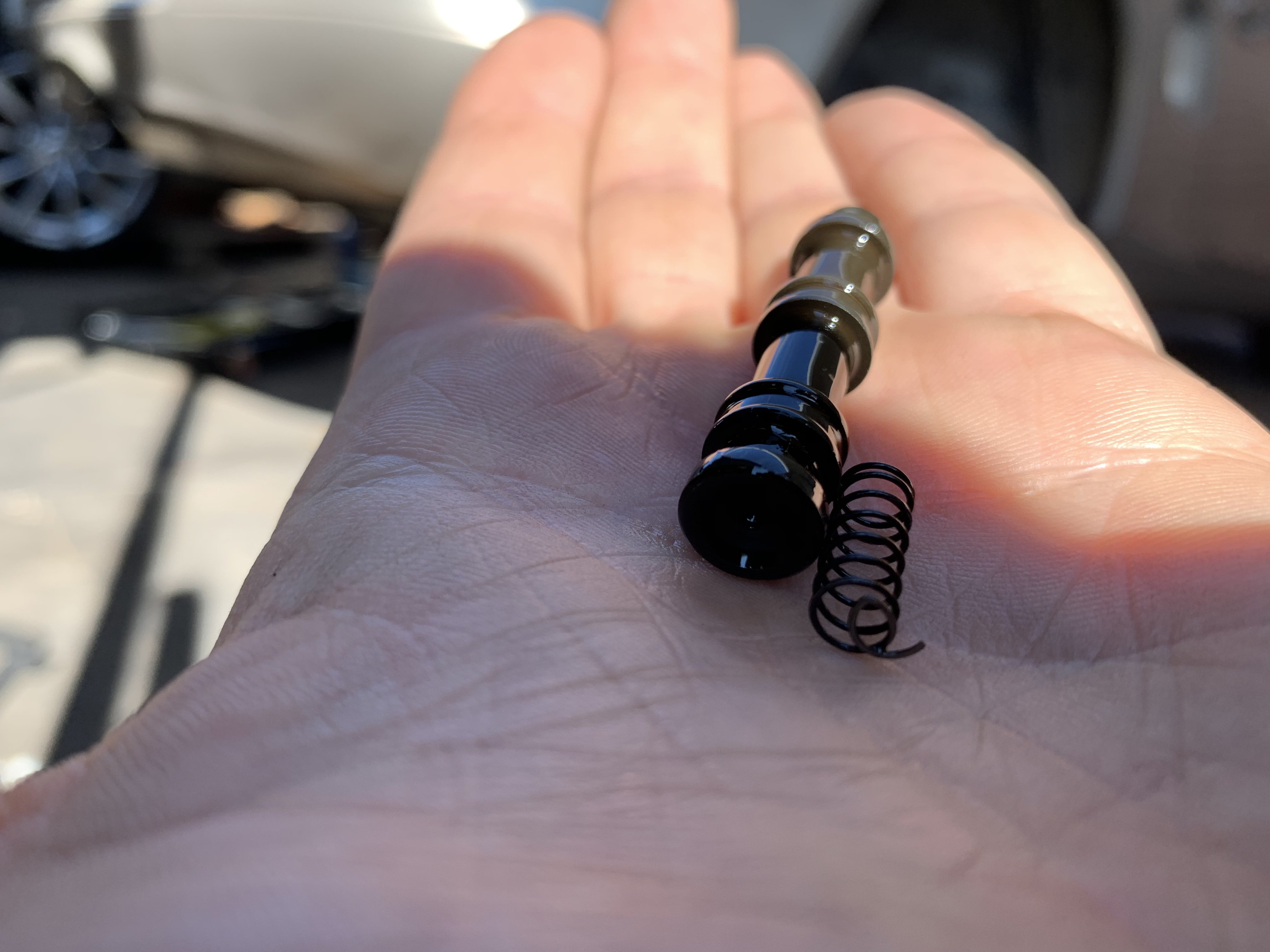

  3. Yes came out like that. I’ve re-shaped it. No O’rings at all. It feels a bit loose in its home. Are there meant to be O’rings ? About to pull the cams out. Matt

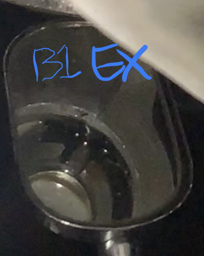

  5. Looks like the intake cams are a bit off. More like 3:15 rather than 2:45 ?
  6. Thanks Ahsai. I’m going to pull the green plugs and check the physical timing today. Im also not trusting of the Autel. Certainly when I activate bank 2 at idle the engine stumbles however the data shows no movement in cam angle. This doesn’t make any sense to me as when I do the same on bank 1 it moves 25 degrees per the data...and makes the same change in engine note Matt
