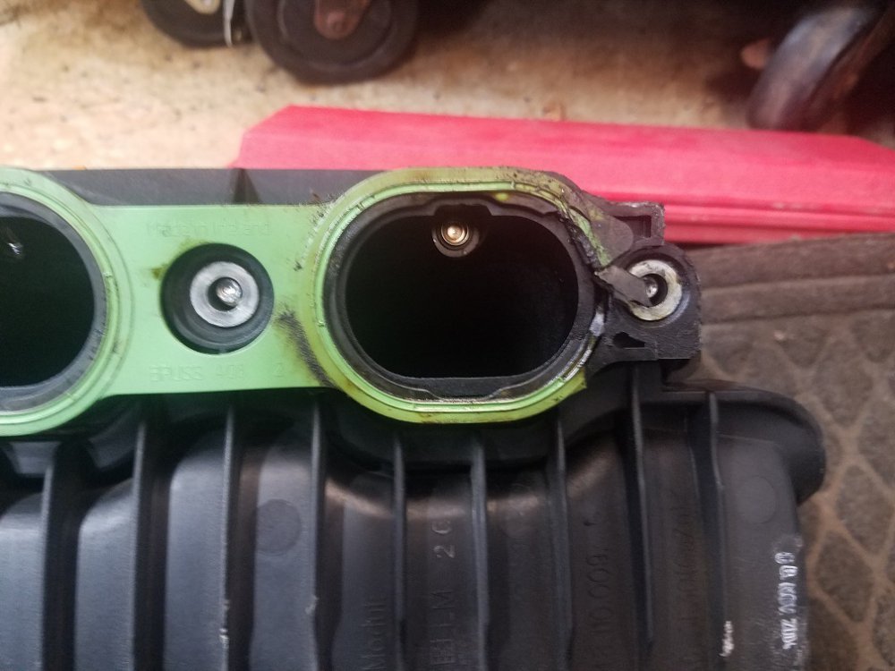

  2. You probably pinched your intake gasket when putting the intake back on. With engine running put a rubber vacuum hose to your ear and place the other end around the intake area of #8. I'll bet you hear a hissing sound.
