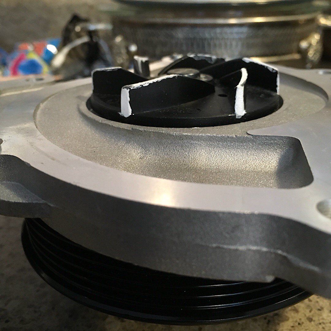

  3. Just an update. Everything is still good. Here are pics of the pumps so future readers can see for themselves not to get a cheap waterpump. (The white on the impeller is white-out that I painted on to see where it was rubbing)

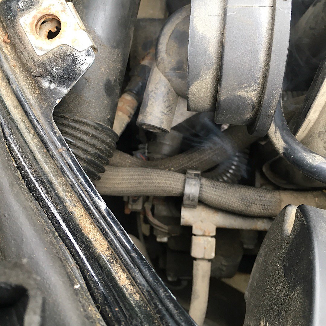

  4. Any updates? I just had these two codes and it was a vacuum leak. The bellows boot came off underneath the air oil separator. Cost $0 to fix. I hope your mechanic knows what he is doing and not guessing. Did he even open the engine cover? If the CEL came back on after his diagnosis then you need to take it somewhere else.

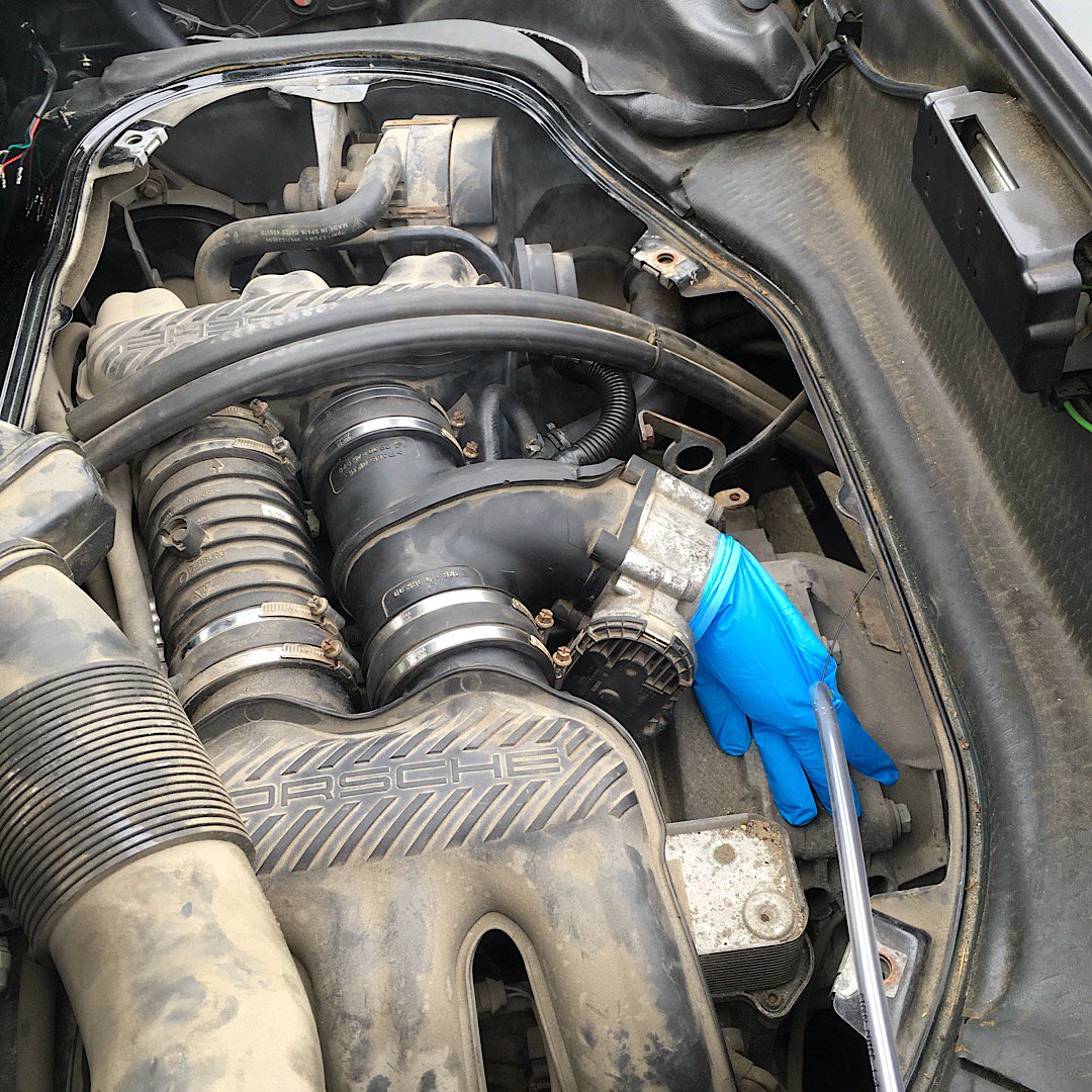

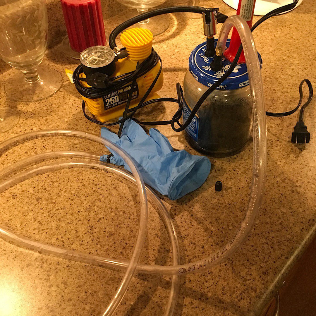

  6. I have the same codes on mine. I made a pickle jar DIY smoke machine. Worked GREAT and cost about $8 including the pickles but I already had some items laying around. Search youtube for instructions. I made a couple modifications: Instead of bic pen I used two tire valve stems ($2/pair). Drill 1/2” holes for the valvstems and the soldering iron. Remove valve core on one of them and 1/4 hose fits on perfectly. I used $6.99 12v air compressor from harbor freight. Pickle jar I upgraded from 24oz to 32oz to have a wider lid. Use rubber glove with pinkie fingertip cut off to attach to 1/4” hose and adapt to the large intake hose by the throttle body (have to remove the hose between throttle body and MAF. I used hot glue to attach the soldering iron so I could remove it later and because it was faster/easier than epoxy. I believe I found my leak is the bellows under the AOS. Hard to believe but this works perfectly. I whipped it up this morning and was smoke testing within an hour. Haven’t had a chance to do the repair yet but I think I now know the problem.

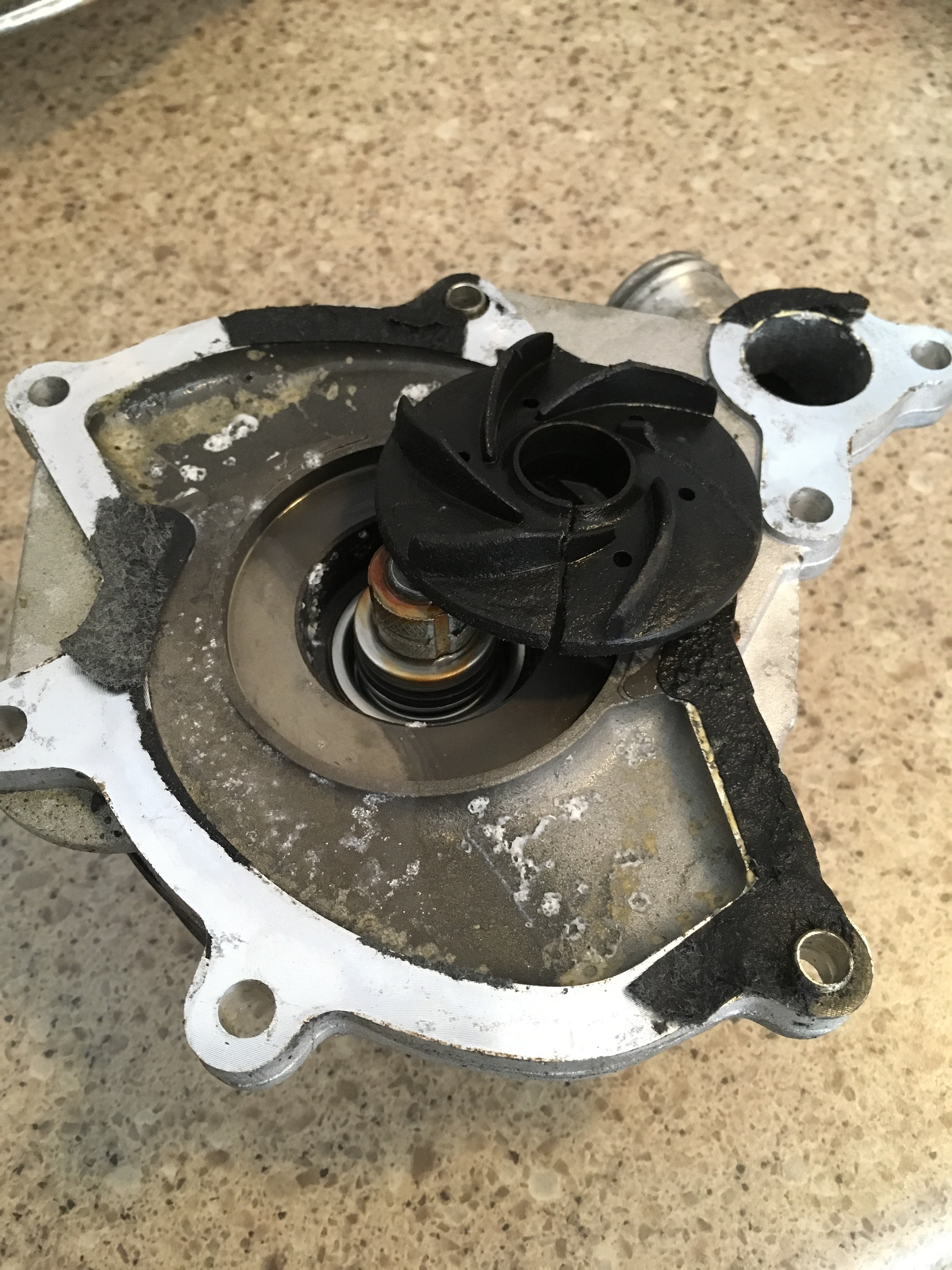

  8. I put in a Pierburg and it is working great on initial test drive. I have nothing to compare it to except the Gates pump. Gates pump is complete garbage!!! The impeller bearing is mounted off center which as causing the binding. On top of that, the impeller was out of round. On top of that (!) the impeller was mounted too high on the bearing shaft. So it rubbed on the tips at first. I filed them down. Then it rubbed on the top edges when the screws were tightened down. Completely unusable piece of garbage! I don’t even know how they can get by selling it. No wonder the brand new gates only lasted 600 miles before it shredded. Also, the impeller is totally different material. Cheap molded plastic on the gates and the Pierburg has some type of composite material that seems almost metallic. Pierburg had a couple pieces of slag (not sure what to call it) that was from the casting. It didn’t look like that great of a casting job. I chiseled off the little bit that was on the inside where the water flows. There were a couple blemishes on the gasket surface too that I sanded down with 600 grit just to be safe. Maybe they are seconds that don’t meet Porsche quality requirements. Said made in Italy and had a 996106101 part number. Thank you so much for all your help and I will be back so you can say “I told you so” if this pump fails me!
