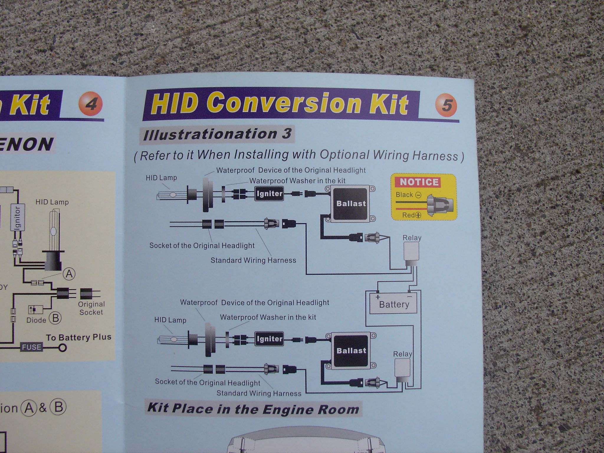

  11. Ok, I don't seem to be getting to far with all of this. I am beginning to think that the DIY HID kit was a bad idea! I would like to know how to disable the DRL circuit on a Canadian 987? Or at least where the DRL relay is? Thanks

  18. Well an update from CQ Light, a little insight but not quite enough to get going yet... They said "disable the DRL" but could not say how... They said 'turn on your lights", this is the first thing I tried, and strangely it had no effect! I would have thought that turning on the lights would have supplied full power to the HID ballast. Anybody know why this is not the case? They said " install the optional harness", this powers the kit through a relay directly from the battery... investigating Here is a picture of the optional relay harness:

  23. I would like to know where this relay is located, also if it can just be removed to deactivate DRL on Canadian cars? On a 986 I found it on sheet 21 for the Relay Support/Carrier assignment, but I don't have these diagrams for the 987... Reason, I have a HID kit and it would seem that this circuit affect the HID ballast due to it's reduced current... I was hoping to try the removal as a fix to make the HID work.
