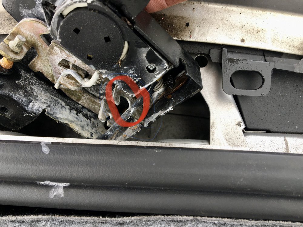

  2. Found the problem with door lock. When door latch mechanism was replaced the arm off the back of the lock cylinder was not inserted properly. Fixed that it’s working again.
