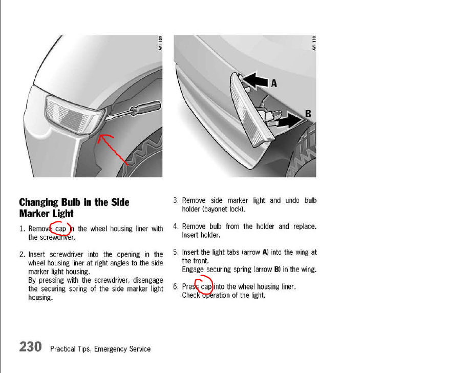

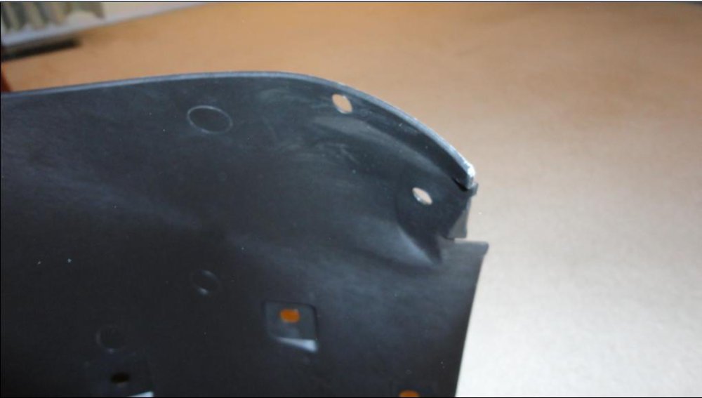

  6. Thanks. Yes, I've read it over again and you're right. And no, thanks, I don't need a P/N for the side marker itself. I thought this "cap" was missing. I asked the local dealership parts guy, he said he is not seeing a p/n for it by my VIN. I noticed a 996.1 lifted up in their shop we walked over that pup is not having any caps by the side markers. The parts guy said a cap might be included with the wheel housing and I just had picked a brand new front RH wheel housing yesterday because the original is cut off by the bottom. The wheel housing is not having any caps for the side marker where it goes in by the top on the outer side.

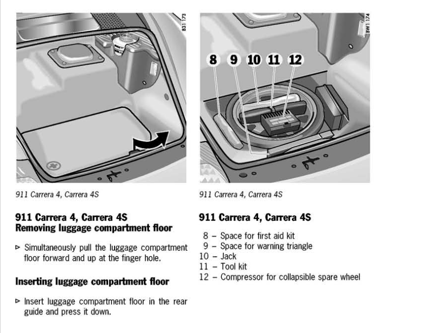

  7. Correct. My 987 is having the air compressor as those pups along with 997s are not having a spare no more😉 so you got to make it somehow. I also tend to think the C2/Targa/C2 Cabrio are not having the air compressor as it says in the manual to maintain 60PSI spare inflated at all times. Only C4/4S/Turbo/GT2-s having it as their spare is kept deflated. The First Aid kit in C2/Targa/C2 Cabrio goes on the RH wall (item #8) there is a strap. I have added a CD Changer to my 996.2 so it's a perfect place for it in front of the CD Changer. I can put the First Aid kit into the strap where it should be but seeing a hood lid lip is right up there when the lid is closed so it might rub the First Aid kit zipper against the lid you don't want that. The Warning Triangle (item #11) for C2/Targa/C2 Cabrio goes into a spare wheel pocket bag.
  8. Anybody can suggest on a P/N for the 996 front wheel housing side marker cap? I am not seeing it in the parts catalog maybe it's listed on some other diagrams?

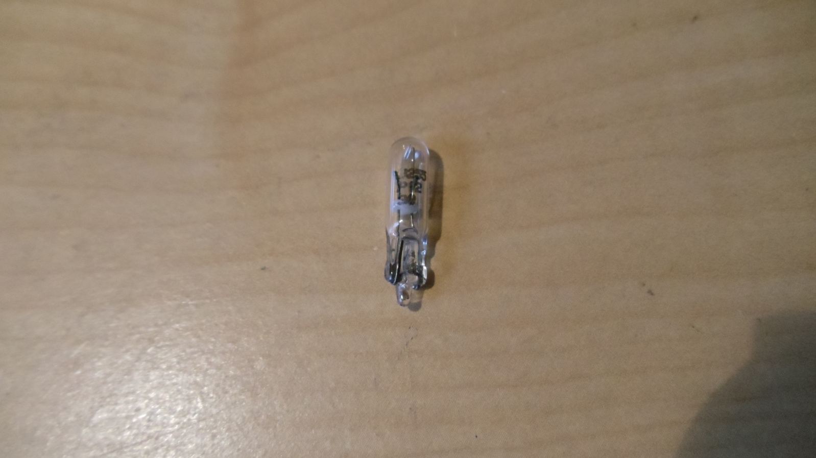

  9. I put in today the 900 631 132 90 Bulb 12V 1.2W and that's the bulb.

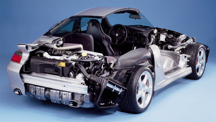

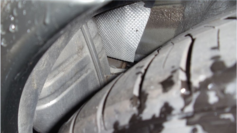

  11. I see. The GT2 Turbo have the muffler by the rear bumper and behind the rear wheel housing are the intercoolers.
  12. Makes total sense weird though GT2/Turbo having the whole plastic wheel housing their mufflers have much greater heat production as even the rear bumper has side grills.
  13. I am seeing in the parts diagram and on a couple of videos on the YouTube that a regular 996/996.2 non-Turbo/non-GT2 are NOT having the rear end of the rear wheel housing. Can someone with a non-Turbo/GT2 confirm please? It's sort of the rainwater fountains right at the mufflers...
  14. Anybody knows which kind of bulb is used in the 996 cigarette lighter? The reading on the factory bulb is: J255 P12 30 Is it a regular 900 631 132 90 Bulb 12V 1.2W or - my computer returned a hit on the reading from the bulb for 12V 1.12W? Thanks

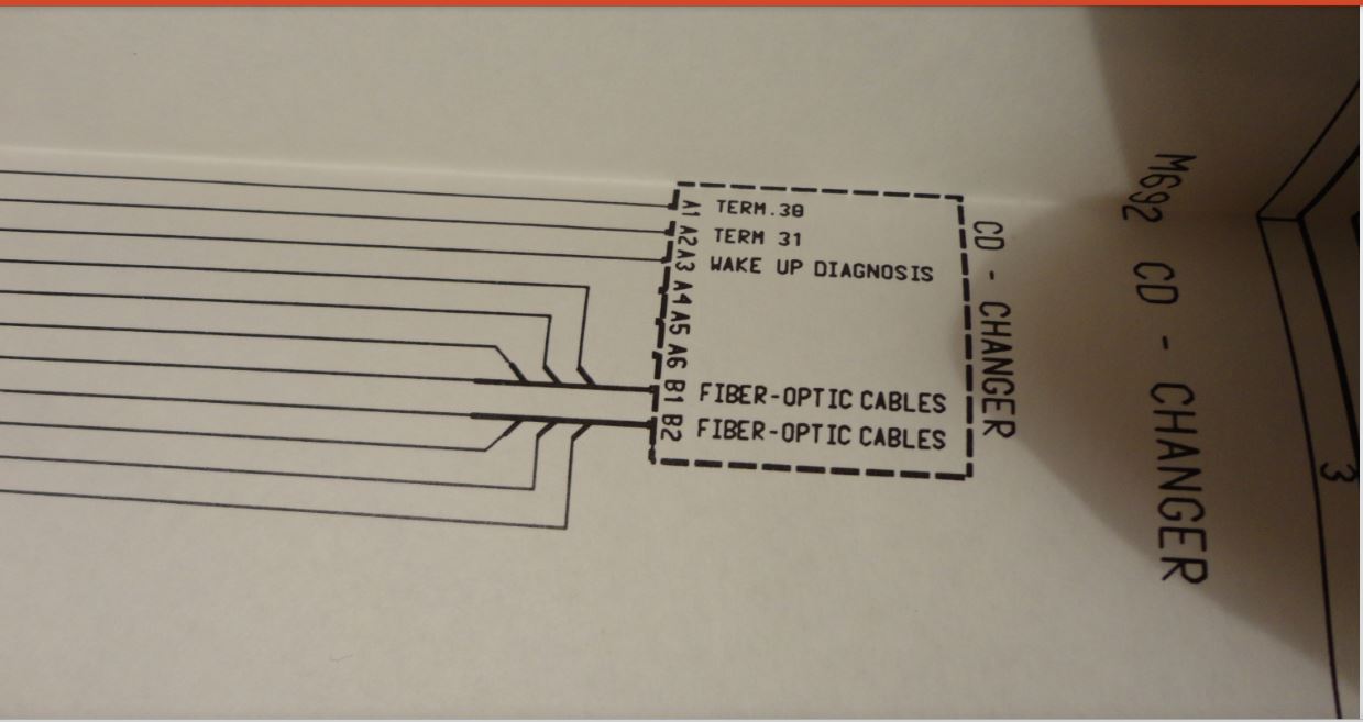

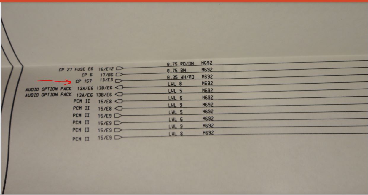

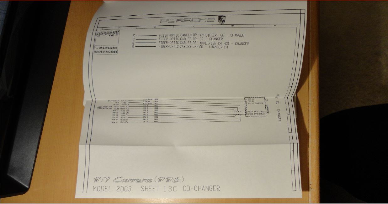

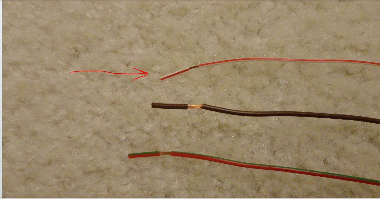

  18. I am also retrofitting the CDC-4 CD Changer. I don't see anybody mentioning the White-Read (Wake-UP Diagnosis) wire. Where is it going to?
