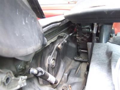

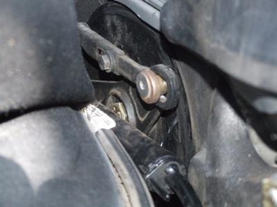

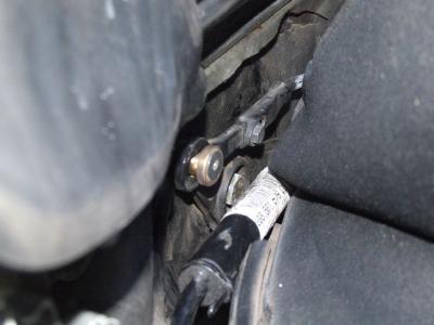

  3. Ok, I noticed something strange. This is what the V arm position is when the top is still fully up, with the clamshell clip disconnected: This is what the V arm position is when I lowered the roof manually: Do these seem right? I think the black ball joint lever arm should be on top of the red ball joint lever arm when the top is down. As it is, the top doesn't go down completely because the black ball joint lever arm gets in the way. This would also mean that the resting position of my V arm on the transmission is wrong in that the arm towards the front of the car should be pointing downwards rather than upwards to facilitate the correct movement of the black balljoint lever up, and the red balljoint lever down when the top is being lowered. Can someone verify if what I say is true? If so, it would look like that both my transmissions have come off gear at the same time.......... Can I simply push the transmission back in gear by pushing on the V arms or do I need to open up both transmissions to do this?
