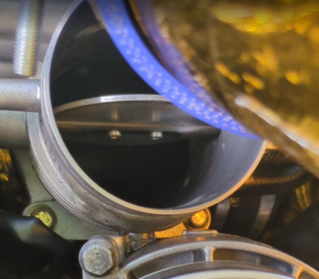

  2. Have been using my Durametric to try and isolate a misfire on my 1999 (DME 5.2.2) cable throttle 996 C2 (race car) which has a RoW tune. Unrelated to that testing I noticed the recorded Throttle Plate Angle when pedal is fully depressed (WOT) is showing 78%. A visual indicates my throttle body plate is easily opening to 100%. Do I need to worry about the DME getting this 78% signal when in fact it is 100% or does it calibrate itself but not show a calibrated value in the software?

  10. >> it looks like the throttle body is jamming or something. This would be independent of RPM. Don't tear it apart yet.
