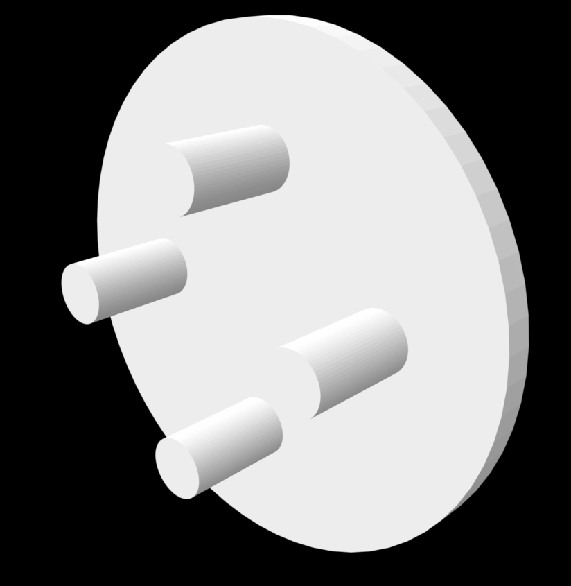

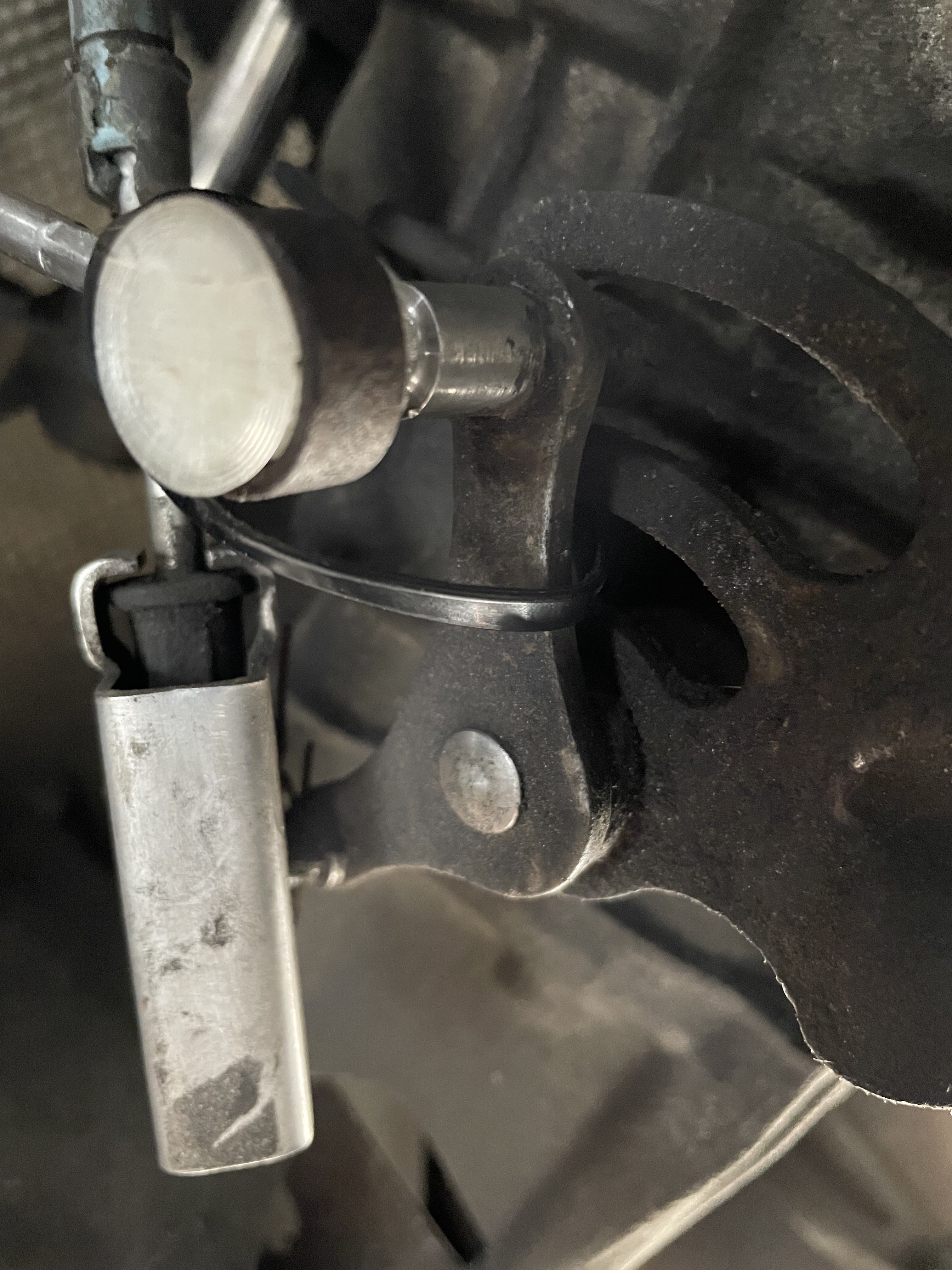

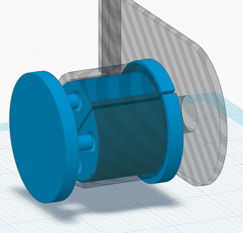

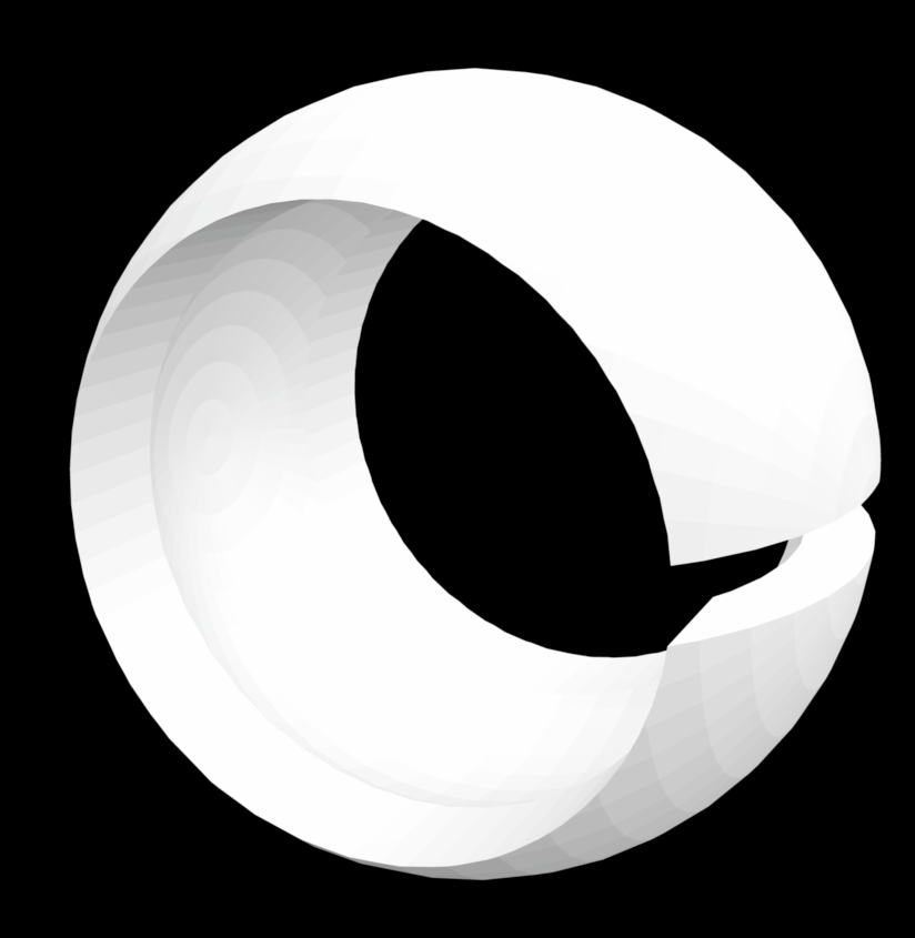

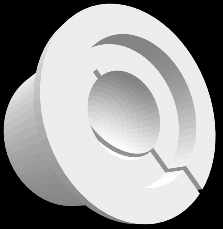

  3. Last week, on our way from Holland to Hamburg, I had to reverse into a slot at the gas station when I lost 1st/2nd and 5th/reverse gears. Carefully manoeuvring the hot exhaust and cats, I managed to attach a zip-tie to the detached linkage where the rubber insert had perished (old age?) Gear 1 thru 5 selectable again, but due to the slop (both top and bottom) no reverse.. Porsche's official solution is an upgraded set of shifter cables (986-424-041-10) and linkage assembly (986-424-913-06) at a cost of over a thousand euros. Recently acquired a 3D printer and started messing with tinkercad (a browser based basic version of autocad). Came up with these inserts that appear to have fixed the problem at a cost of less than 2 euros in filament (PETG) and a couple of hours of my time. Insert with socket for lower (8mm) ball joint. Securing plate that gets glued to the backside of the insert. Still had some slop in the whole linkage making it very difficult to engage reverse, so popped the upper ball joint loose, sliding off the securing clip. Rubber / plastic pretty worn, so identified the culprit slop. Designed this insert that fills in the worn plastic and fits perfectly over the top ball joint (10mm).. Problem solved (hopefully) 🙂 STL files available on https://www.thingiverse.com/thing:4925982/files

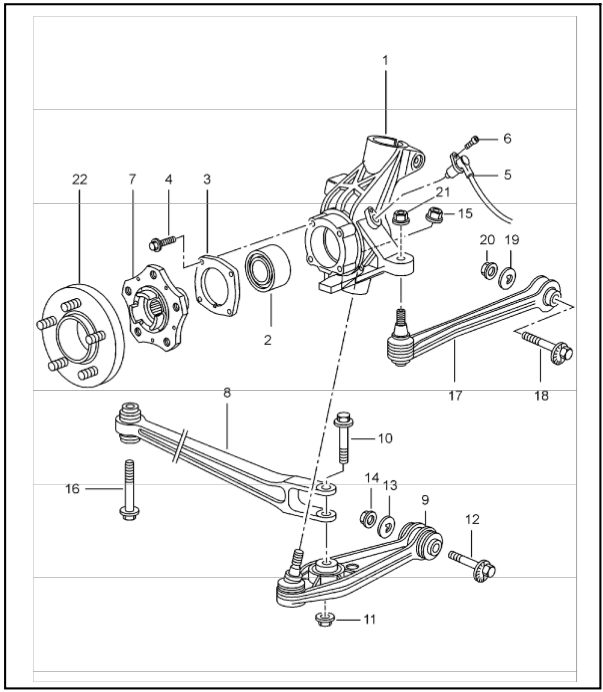

  4. Replaced the lower control arms (#9 in pic) on all 4 corners a while back, but still noticed rattles when going over cobble stone roads (of which we have a lot here in Europe). Also when lifting off the throttle at speeds over 30/40 kmh, I noticed a vibration coming from the right rear, similar in feel to the rattle when going over rough surfaces, albeit less intense. Time to replace the a-arm / control arm (#8 in pic), suspecting play in the ball joint. Thought it'd be informative for you guys to see the difference between a good (used) one and the defective a-arm. No subtitles in the video, but you get the gist. The bad one moves ever so slightly, certainly noticeable to the touch.. WhatsApp Video 2021-07-27 at 12.28.39.mp4 Test drive confirms my suspicion that the rear vibration also had its root cause in the a-arm. 🙂
