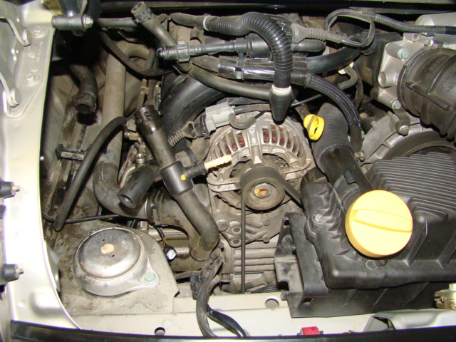

  22. I have what looks to be a leak from the coolant tank area. Any suggestions as to the best way to DIY?

  24. I have a 2000 996 with 34K miles that has an occasional leak from what appears to be the reservoir cap. I can see crust around the bottom of the cap and around the screw lip on the reservoir (see photo). The coolant appears to be dripping down the overflow hose and onto the driver's side muffler and onto the ground. I have topped off the reservoir and the temperature gauge reads 180 degrees when warm. Is this common?
