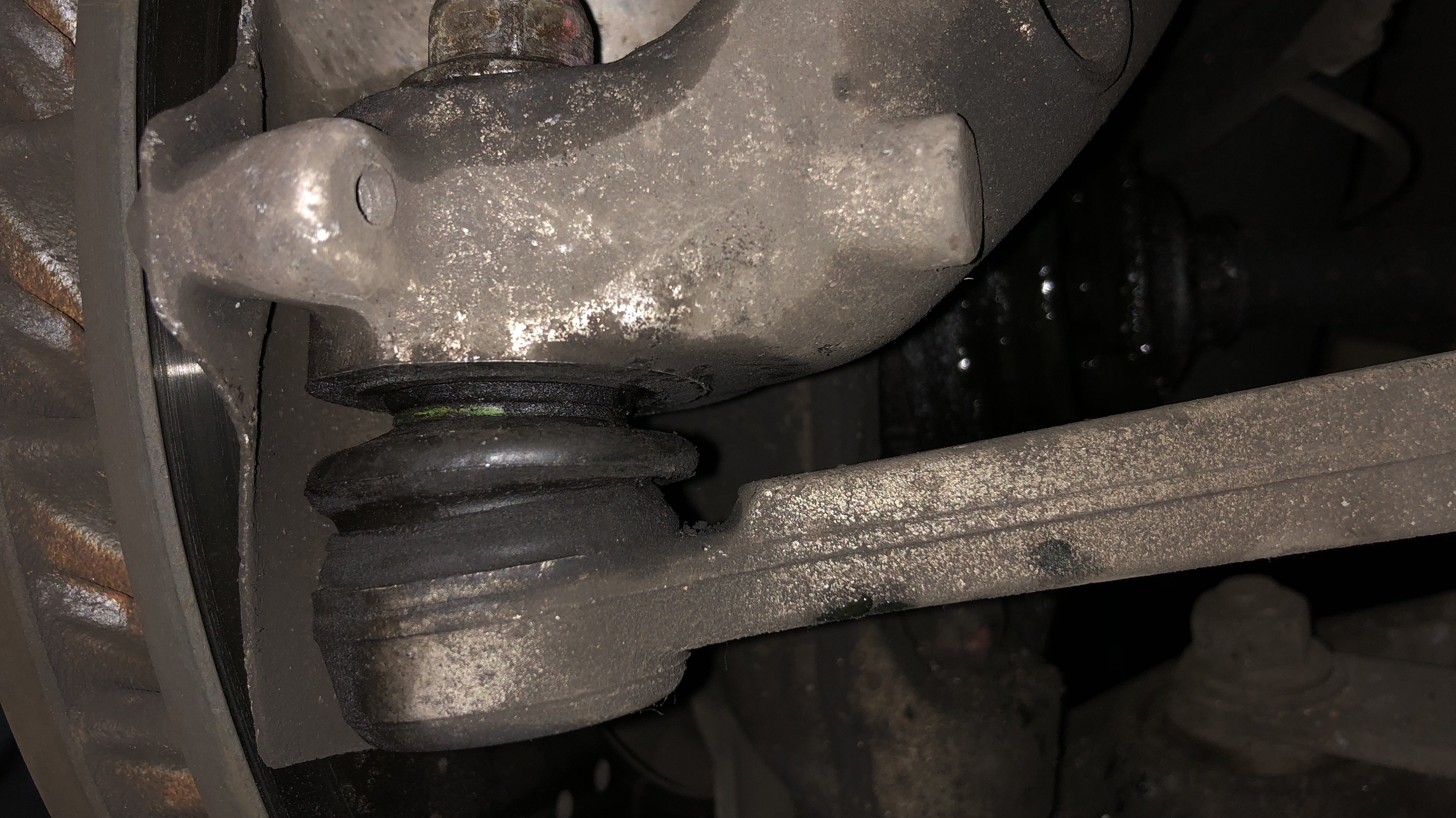

  2. Hello, I am a little confused and could not find an answer yet! I need to remove the front struts to replace the strut mounts. Therefore I need to crack the ball joints of the track rod and the control arm. In the manual is referred to a special Porsche tool 9560 (C) for the control arm and a commercially available tool (B) for the track rod. Since I want to buy the correct tools, I have some questions: -The tools look very similar, except that the one for the track rod has a flat outside and the one for the control arm a flat inside. Is that correct? -Except the size the 2 ball joints look very similar to me. For my understanding the tool with the flat inside would also be the besser option for the track rod (foto). How can the proposed tool (B) work here? -What are the required sizes (jaw opening) for the joints? Thank you for any help!

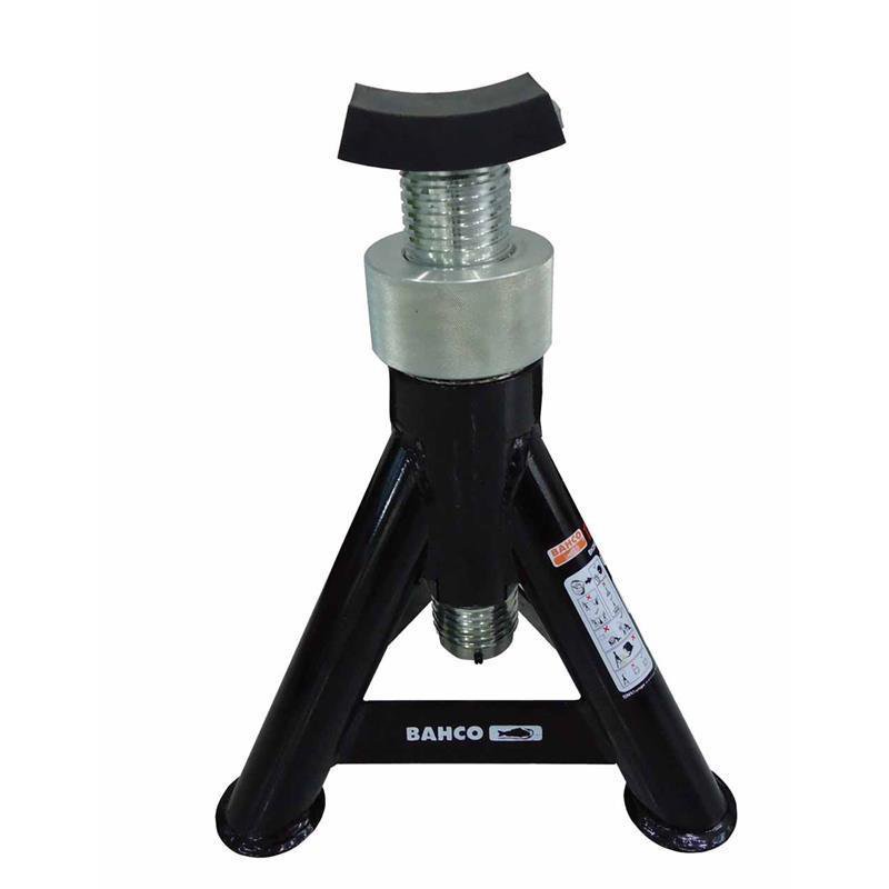

  4. Good to hear from someone with experience. I will give this a try then. This is a 12t stand from Bahco, a European company. I like the way to adjust the height and very solid. Gives me a good feeling under the car...
  5. I was thinking of using such kind of jack stand, which is adjustable as well. So, from your experience: Will this be wobbly! Unfortunately I can not weld this bar by myself and these stands I have at home

  8. Hello, I am planning to replace the clutch of my 996 4s and therefore need to remove the transmission. I will put the car on these 20" (max) Bahco jack stands. Would a 5th of this jack stand also be able to support the engine? In my opinion the effect is similar to the original Porsche tool (except that it stands on the bottom and is not connected to the car). The stand could be screwed exactly to a height "touching" the crankcase. Or am I wrong and need more of these or something different? Further I need a transmission jack! Can someone recommend one? What is the maximum lowest height of this jack to remove the transmission from under the car. Thanks for hints! Gert
