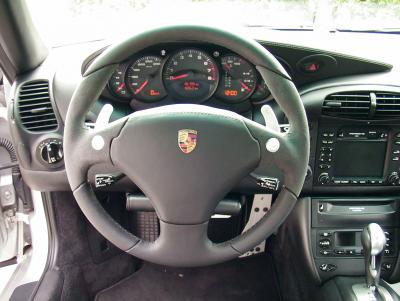

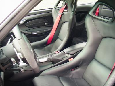

  2. Not cheap. But it's specially made after my spec.( colour, alcantara, size etc..) 1900 euro. Looks very cool. I like the seats too, are they the GT3 Sports seats? Have you got a link to the website to buy the F1 wheel? Was it a big job to change? Thanks. Yes it's the GT3 seats from Porsche (Recaro). Check this link. www.fvd.de , see under interior. They have this wheel in 340 mm diam. Mine in custom made 360 mm and delivered from RUF. I think it's the same manufacturer. You ask if there is a big job to install? Yes and no. If you are lucky the new steering wheel will be in center when you driving straight. Then it's 20 minutes. If not, you have to correct this with a wheel alignment. I had to do that. You also need a PIWIS or Duametric SW to reset airbag foult codes after installing.

  4. Not cheap. But it's specially made after my spec.( colour, alcantara, size etc..) 1900 euro.

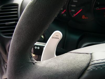

  8. I installed a new steering whel from Ruf. This is with F1 paddle shift and works much better than the stock. It gives a lot better control espesially on tracks. Some pictures:
