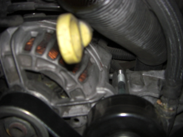

  1. Also, you might notice in the picture above that just behind and to the right of the idler pulley are two coolant hoses that join together with a plastic connector. You can see the upper hose and the plastic connector in this picture, with a little bit of brownish leakage/corrosion on top of the plastic connector. I very, very, very gently tapped this connector with my fingernail, and it disintigrated, with both plastic nipples (top and bottom) breaking off inside their respective hoses. Better now than out on the road in the middle of summer I guess. If your car is more than seven years old, I would suggest replacing this cheap little plastic connector before it leaves you stranded.
  2. One important piece of advice and one question. First, the advice - be careful of the oil filler tube when replacing the belt. Plastic tends to get hard and brittle with age, and I barely bumped that sucker with my shoulder or arm when pulling off the old belt and it cracked and popped clean off. Now I either have to pay for a new part and spend a few hours removing the alternator to replace it, or glue/epoxy/tape the stupid thing back together. The question - perhaps I was not getting proper leverage on the tensioner pulley, but I had a heck of a time getting enough slack in the belt to install it. I used on old trick that I have used on many prior vehicles - removing one of the pulleys and re-installing it with the belt in place. In this case it was the upper ilder pulley just to the right of the alternator - identified as number "3" on Loren's diagram. The bolt on which this pulley rests also appears to be one of the two bolts securing the alternator in place. It is a smooth bolt at least six inches long, with about an inch of threads at the end. Once through the pulley and the alternator, the bolt rests in a "U" shaped channel, which looks like it should have a section with a threaded hole at the end to mate with the threads on the bolt. Alas, it does not. Was there a nut on the back on this bolt that quietly disappeared into the depths of the engine when I removed the pulley? Is there something else I am missing? You can clearly see the bolt and threads in the attached pic - which is only possible because I was able to pull the stump of the broken oil filler tube up out of the way and wedge it over the dipstick. Thanks in advance for help on this one.
