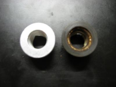

  1. Having removed it finally, I can see that the bushing was frozen solid. That bushing made it a pita rather than the simple job it is.
  2. I'm stuck. I have the left side bolt out and it swings up by hand but not high enough to clear the bracket. The right side idler bolt is out but it just wants to pivot on that point. I did the tapping on the idler prior to removal. It just dosen't seem to want to come off that idler point. Any ideas? (I didn't want to add too much force due to the soft metal) Jim

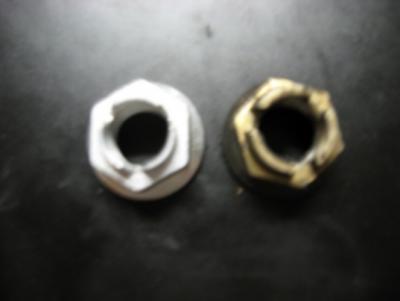

  16. FYI, I went to order a pair of axle nuts (PET # 999-084-641-02) and Atlanta couldn't find them. It turns out the part number changed to 999-084-634-02. It's been changed to a solid Nut rather than a 2 piece one. Jim
