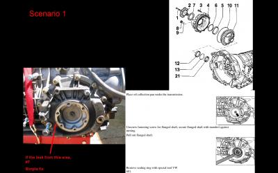

  5. Actually that is the differential Oil, which have a very distinctive odor, and brownish in color. Definitley not a CV Boot issue. Before you start any work, I would clean the area first, drive it and recheck. DIY is possible there are 2 scenarios that the leak is coming from 1. drive shaft flange seal ( easy to do ) 2. differential O-Ring ( little bit complicated )
